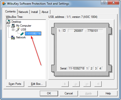

    -make sure that the dongle exist in WibuKey Settings: Click image for larger version

    Are you using the same USB-ports when moving the dongle back and forth or each time the dongle is plugged into different USB-port?
