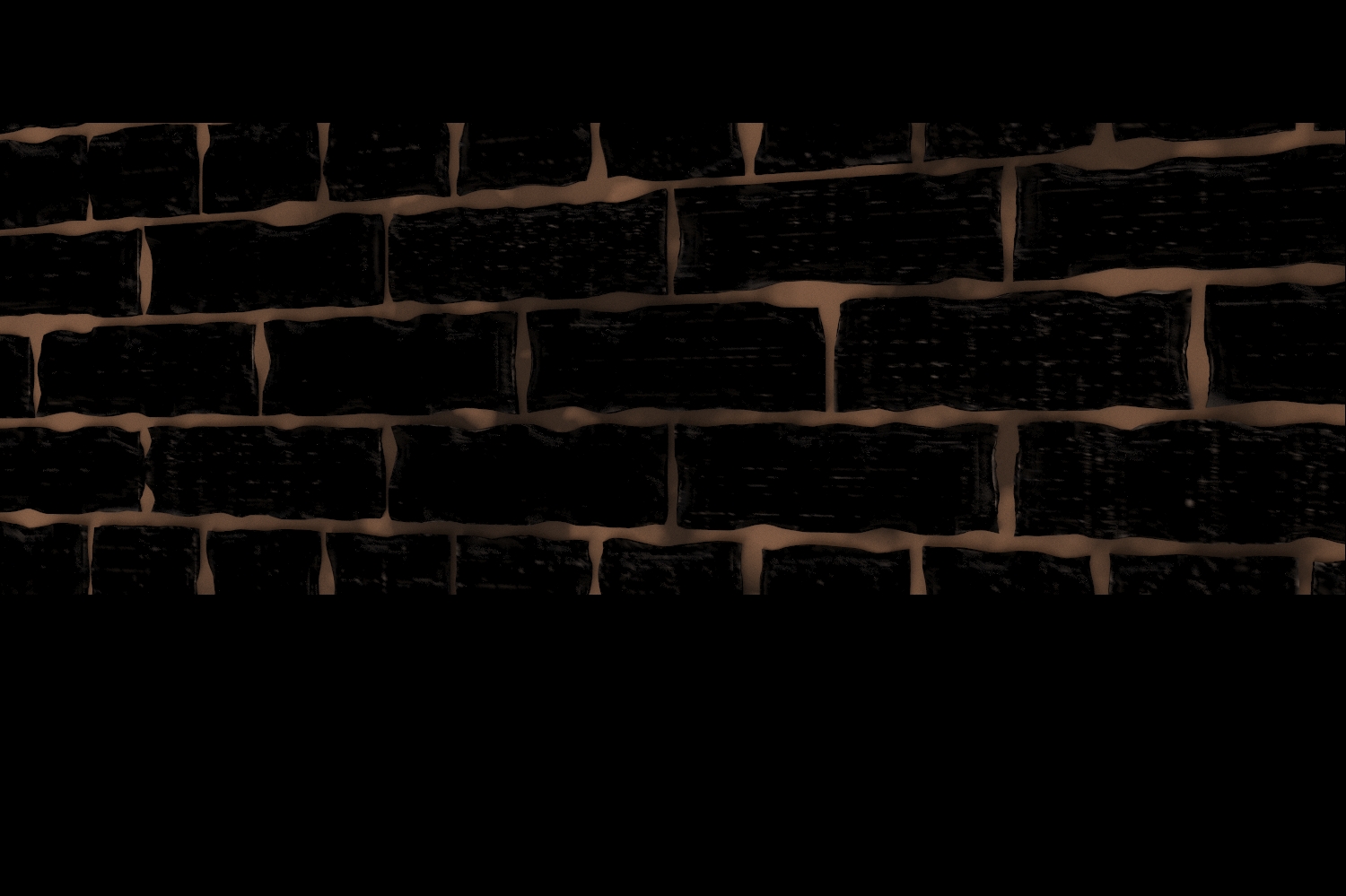

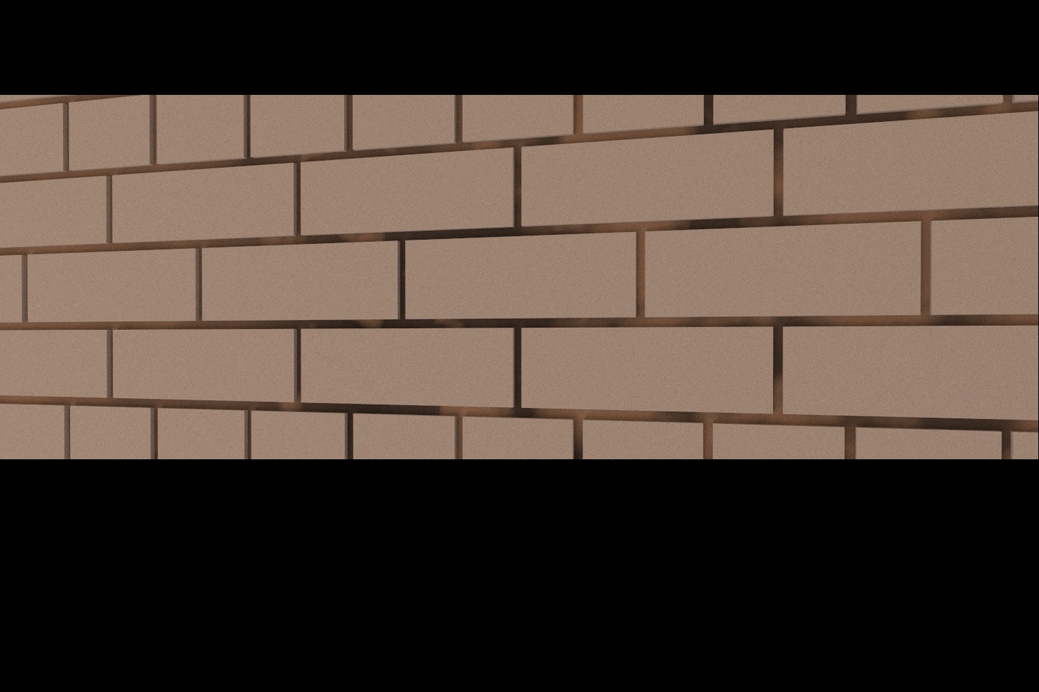

    ive got some bricks that render fine in production renderer and rt cpu, and also fine in rt gpu without displacement.
    when i enable displacement the bricks render black. i can see the displacement appears to be working, from the deformed brick silhouette, but i get flat black shading.
    the material (for testing purposes) is a simple light grey vraymtl.
    the displacement is not so simple, 2 nested mix maps, mixing noise and a couple of bitmaps.
    however i was lead to understand that since the displacement is precalculated on the cpu before rendering, there should be none of the limitations you get with using those maps for other things in rt gpu?

      im uploading a max file to wetransfer.. its got some included maps so will take a wee while to send. sending to vlado@chaosgroup.com.
      in the meantime here are some test images.

        Would it be possible to send the link to: support@chaosgroup.com as well, so we could have a look?
        Zdravko Keremidchiev | chaos.com
          ok i just sent you the same wetransfer link.
            ive sent the file, please also note the displacement global switch seems broken in the latest beta.
              Thank you for sending us the scene. It was a known issue which we are working on.
