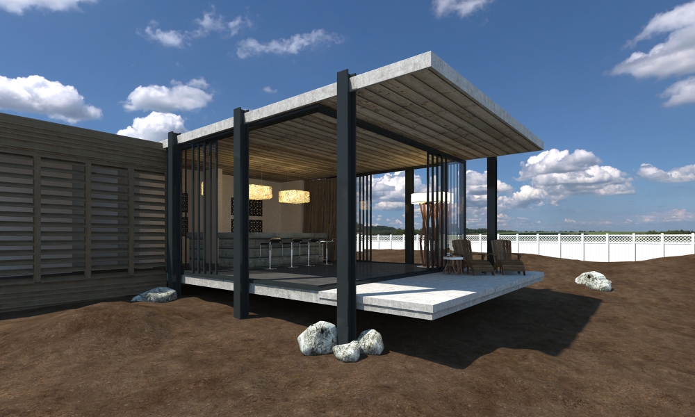

    So I installed vray 3.3 to see if it would render differently.
    here's the thing, if I choose to not convert a 3.2 to 3.3 settings, the image renders largely as expected. (1_noconversion.jpg)
    when I do accept the conversion however, it renders a lot redder (2_conversion.jpg)
    so I'm curious as to what's causing my converted render to be a lot redder and how I can counter
    it by changing settings (which ones ?)
    There was a change in internal colour space in vray 3.3 to srgb from cie.
    If you want the old look run this line of code in the maxscript listener:
    Code:
    renderers.current.options_rgbColorSpace=0
    for the old cie and change the 0 to a 1 for the new type.
