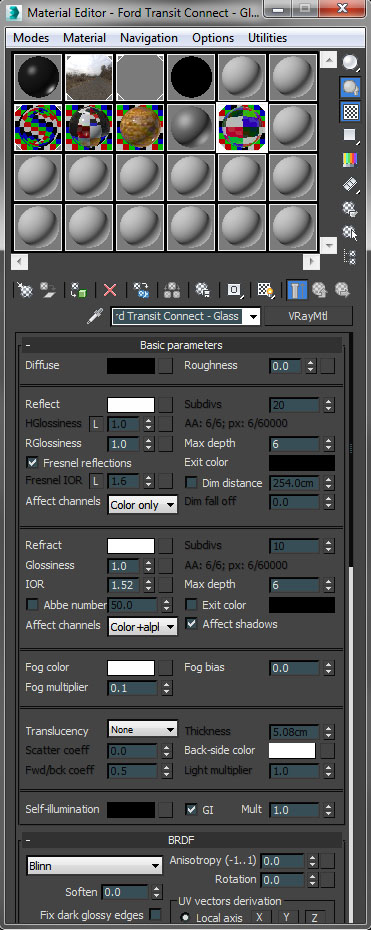

      1) Does the headlight glass have thickness? Can you show the materials settings for the glass?

        1) Yes, they do have thickness. Here's the material of the glass:

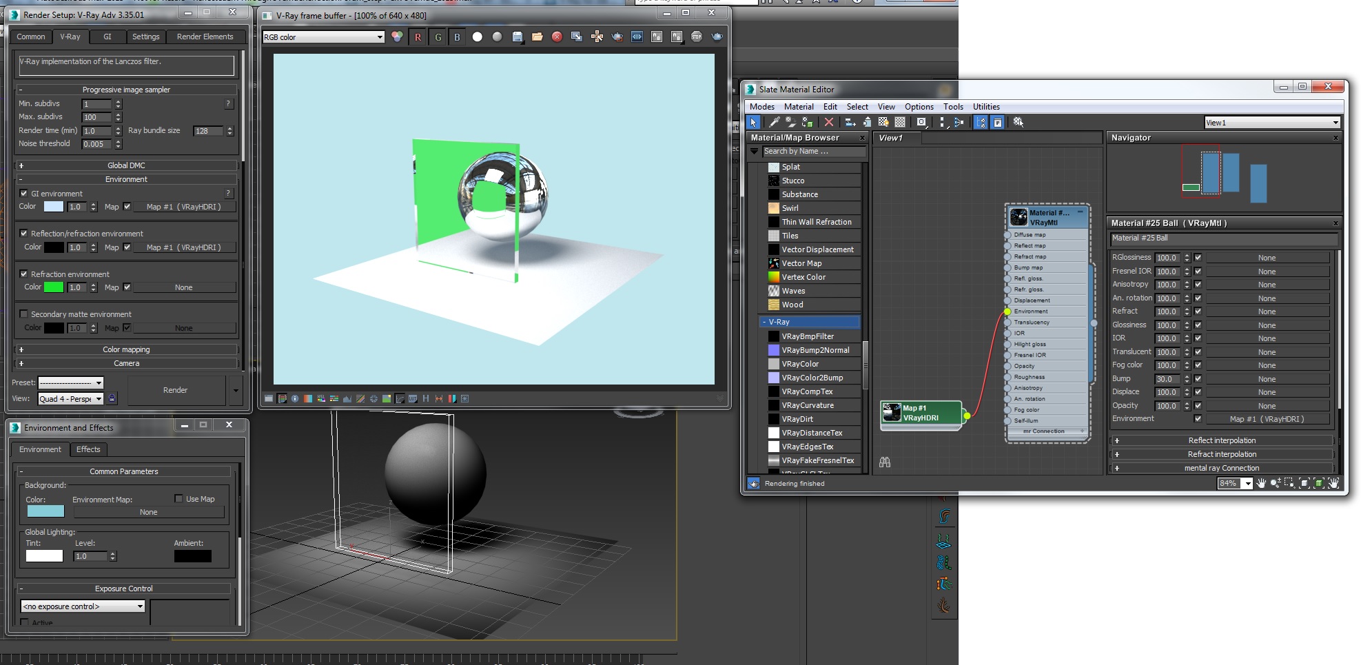

                      Do you mean the reflection of the environment? If that's what you mean, then no, the grey color is not coming from the reflection of the environment. I'm 100% sure it comes from the background. I've made a new example that I hope is more clear (please see below). I've made the background green so that it's more visible and I've added a chrome ball on the bonnet and a stripe of glass in front of it. As you can see, there's something strange happening with the glass. It shows the background where the chrome ball reflects only background. Where the ball reflects the car, no BG color is visible. Shouldn't the glass show the whole chrome ball behind it? I expect that the whole ball is visible behind the glass.
                      I forgot to mention that no object properties were changed on any objects (visible in reflections, visible in refraction etc..).

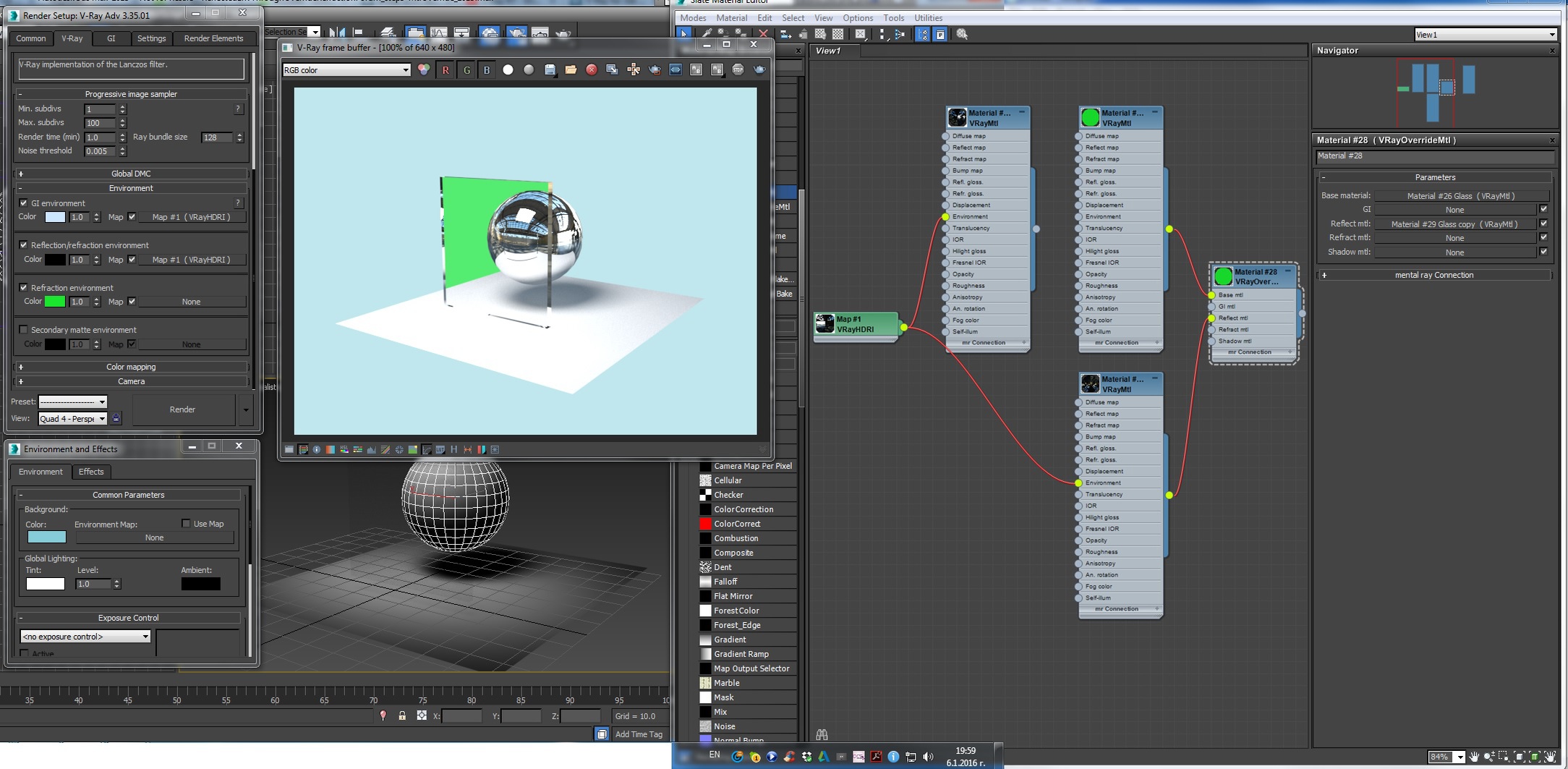

                        If you use the same color for background and refraction environment its a little confusing at first sight. Let's change one of the two colors and see what happens. See the attached images below.
                        So, what happens is the glass is reflected green in the ball. Also, the environment that is reflected in the ball but seen trough the glass is overridden by the refraction environment which is a little unexpected, but it is by design. There is another setting that can control the reflection of the environment through refraction in this case. See the next image below.
                        What I've done is simply place the reflection environment map in the Environment slot of the material for the ball.
                        And for the green color to disappear from the reflection of the box (the glass geometry), I assign a VRayOverrideMtl to the geometry that uses the glass material. I keep the glass material as base and use a copy of it as Reflection material (it controls its appearance in reflections) with that same map that we have for environment reflection in its Environment slot.
                        This would be the setup with overrides. I'd use the dome light instead.
                        Cheers!
