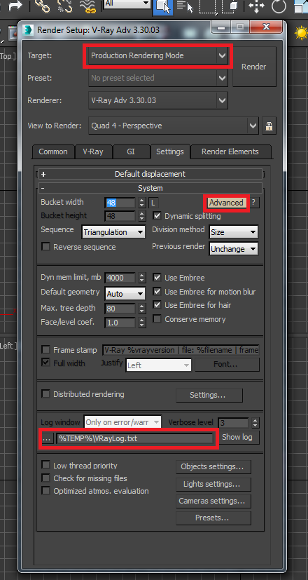

                      This is the only thing in the log after I saved it manually. It's not saving anything to the temp folder.
                      Console created, V-Ray A from Dec 12 2015, 22:55:02
                      [2016/Jan/28|15:56:39] Noise threshold lowered to 0.004329 with 27.5 percent active pixels.
                        The exact path to the log file can be seen in here:
                        after you render something in Active Shade you should stop rendering and maybe even try closing 3ds Max - the log file should be there and it should contain more detailed information.
                        If it is still not present - try to set some new path to the log file - maybe for some strange reason Max couldn't write to the one specified.
