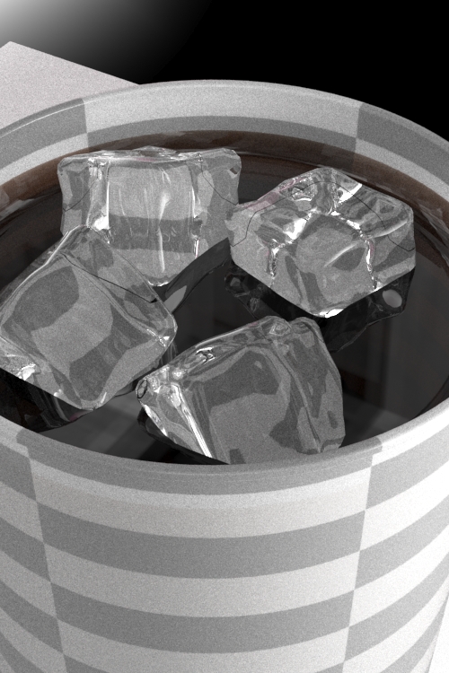

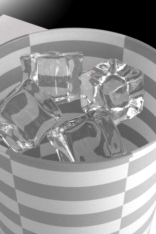

    When I cut refractive object with VRayClipper this object is invisible through other refractive object.
    Cutted object:

    Refractive objects in a holes:

    Result - liquid is invisibile through cubes:
Name:	liquid with cubes.jpg

    It might work better to render this without the clipper at all - just leave the cubes and the liquid surface as they are.

        This problem in particular is really best solved in another way (f.e. volume priorities) rather than the clipper.
