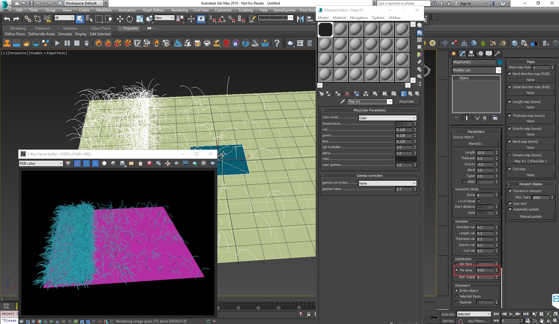

              Here is a quick tutorial how to do it.
              Let's say we have this Fur Distribution:

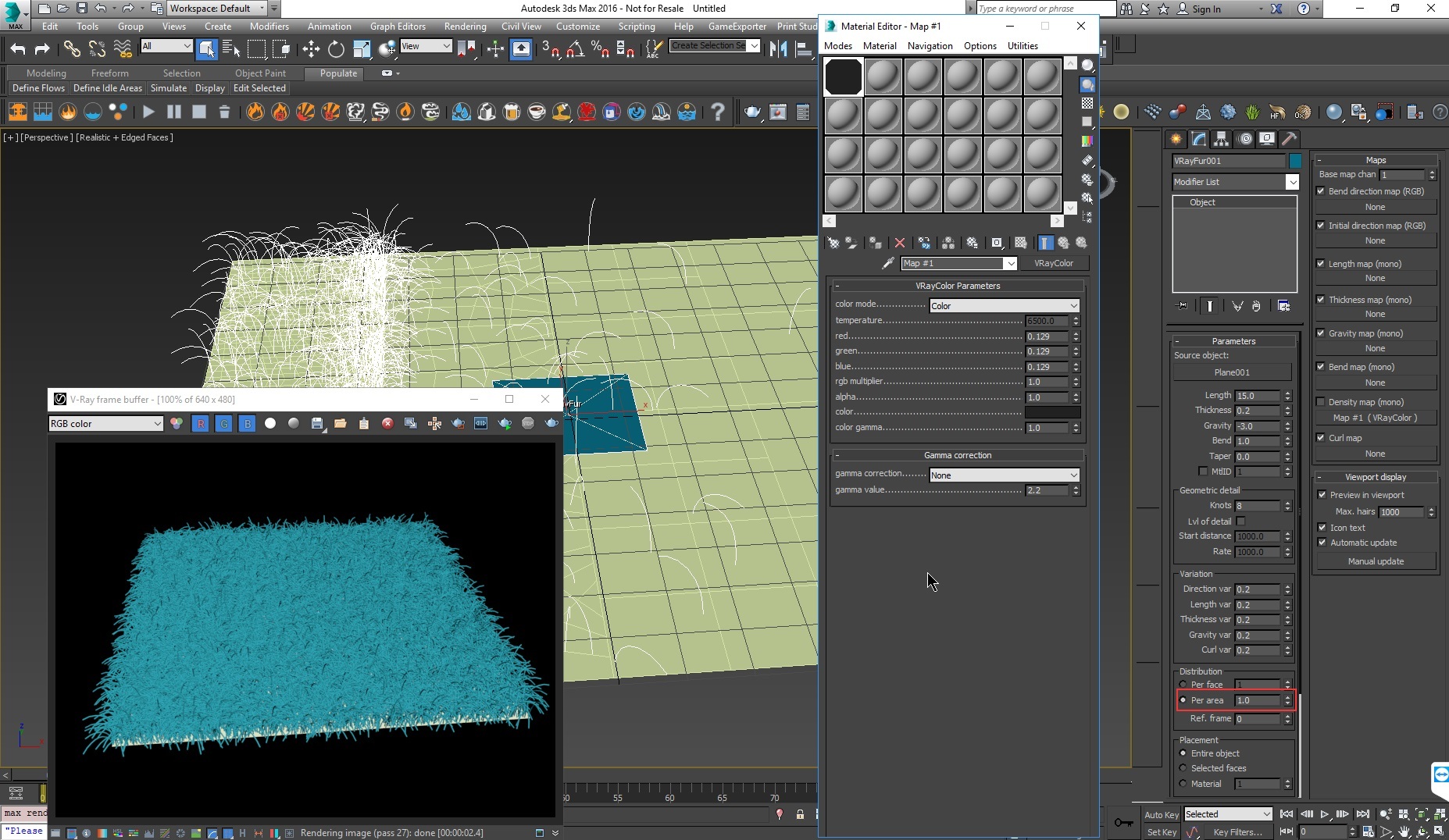

              1.Increase Per Area parameter until you get an evenly distributed Fur like this:
              2.Add V-Ray color to Density map and modify it's color to decrease the number of strands. Black means less strands white more:
