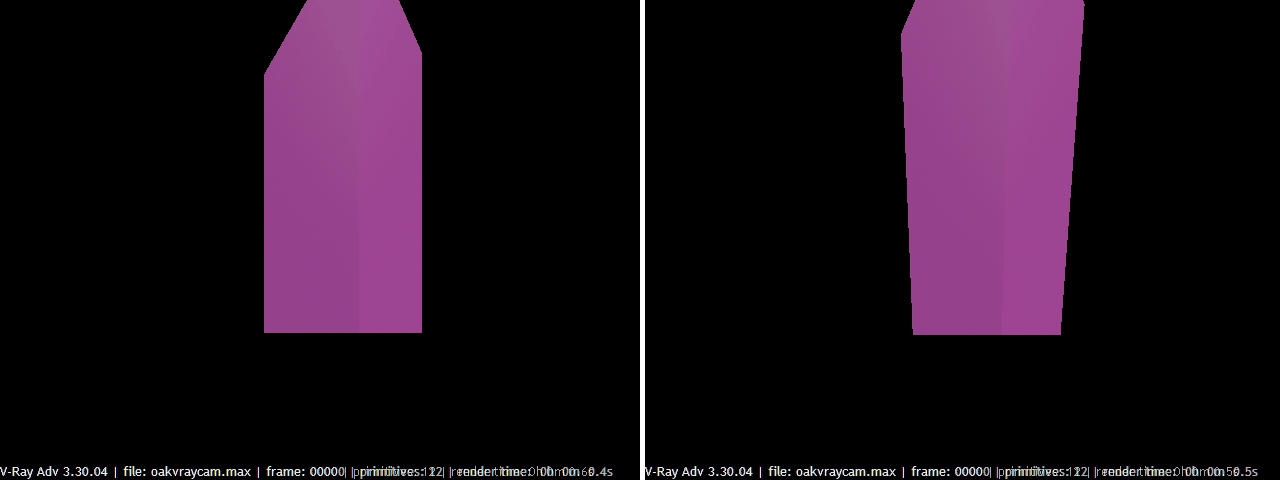

"auto guess vert tilt." is evaluated only the first flame ?
  • "auto guess vert tilt." is evaluated only the first flame ?
    "auto guess vert tilt." is evaluated only the first flame.
    The left figure is the first flame and is a still rendering.
    The right is the first flame that moved Time Slider to 50 and did the animation rendering.
    And by animation, the effect of "auto guess vert tilt." is no longer looked gradually.
    It confirms in Win7 + 3dsMax 2016 / 2015 + VRay 3.30.04.

    I made a note in our bug tracking system.

        Apparently this is a bug in the PhysCam of 3dsMax. Autodesk reported this to be fixed in 3dsmax 2017.
