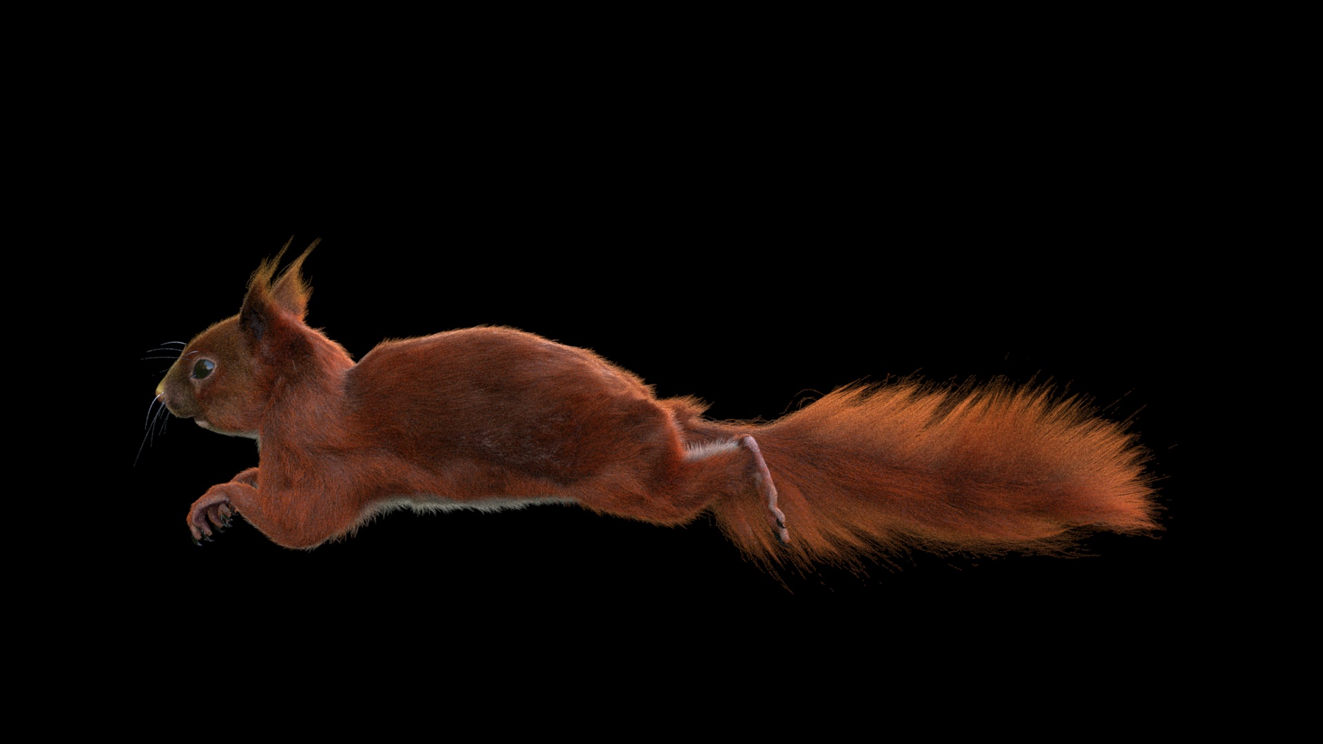

    I am testing Fur loaded from alembic.
    It works very well .

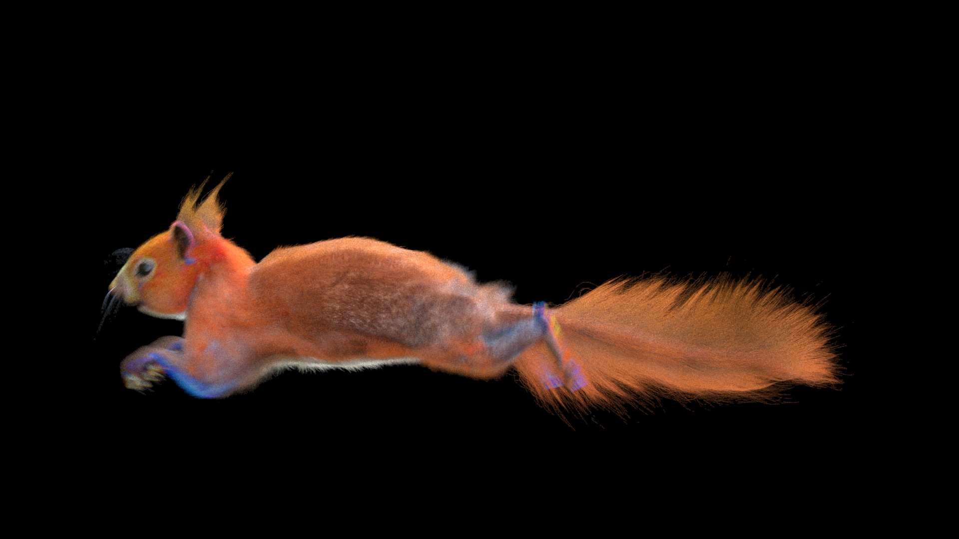

    But when i render with Motion blur ,colors are completely different.
ID:	883584Click image for larger version

    A little better now by disabling Embree
      What if you don't disable embree, but just switch off embree for motion blur?
      Kind Regards,
      Morne
        Thanks Mornes,
        If i just switch off embree for motion blur it's like in my second post (strange funcky color spot) .
        I upgrade my vray to 3.3004 and i recached all with no effect.
        I will try to cache in vrmesh files instead of alembic.
          That looks like a bug, can you sent us simplified version of the scene for investigation?
