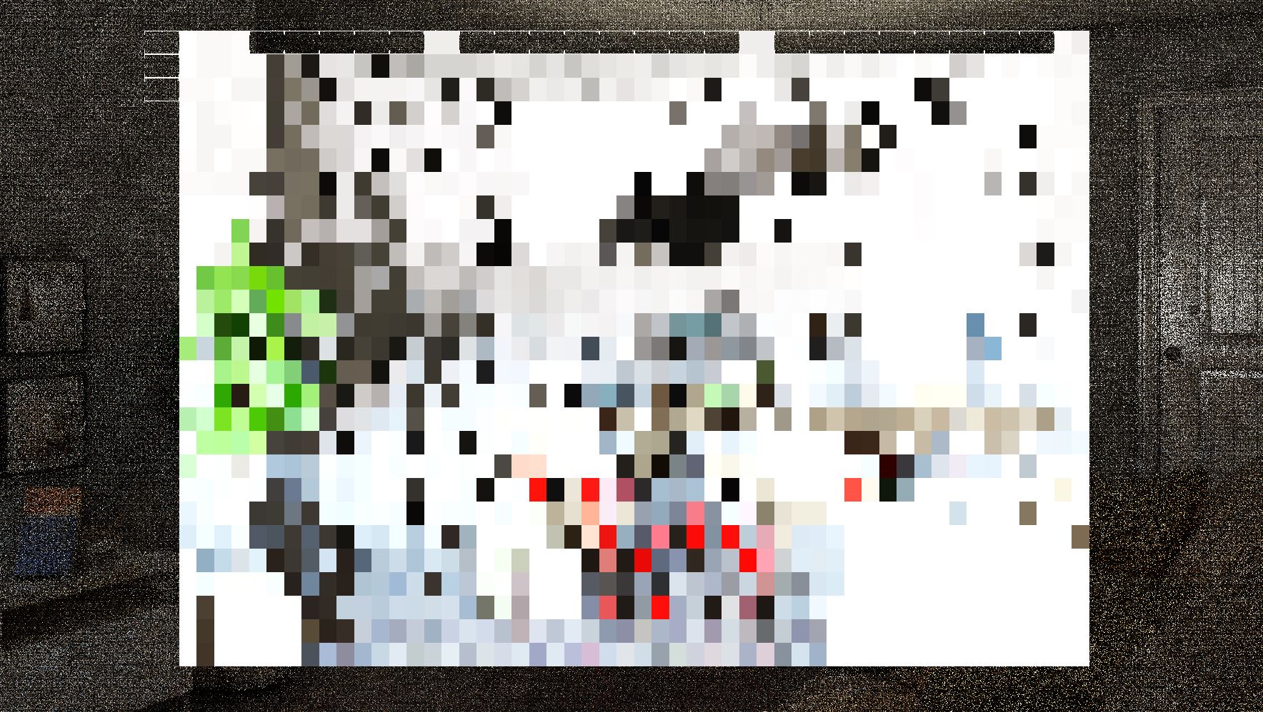

    I'm having issues with my camera. The LC pass shows it dark, however, when it rendered it is way overexposed.
    Simple V-Ray Sun/Sky and V-Ray Camera. I'm using BF+LC.

    Maybe adjust the exposure of the camera?
    Vlado
      Maybe adjust the exposure of the camera? Best regards, Vlado
      WellI I am, however, it's not reflecting in the light cache pass.

        Is the output still overexposed?
        Zdravko Keremidchiev | chaos.com
          I deleted the V-Ray Sun/Sky and added and HDRI in a V-Ray Dome. Everything is working now.
