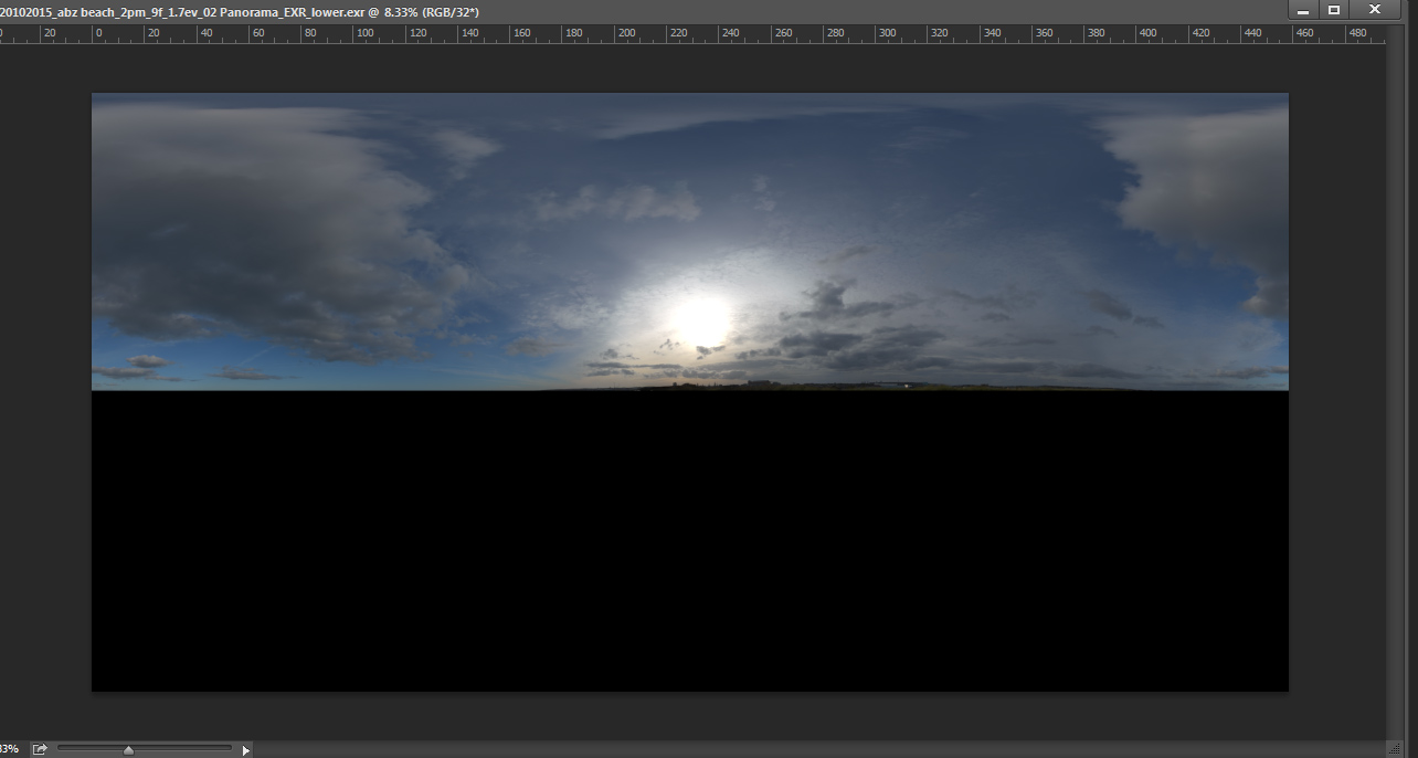

                      Is your hdr high res with some kind of hot spot like a sun? its also possible if you have a dot in the hdr that's really bright it will cause this.

                        yep.. it's a high HDRI.. we take our own... but tested it with cg_source and Peter Guthrie once we have too.... it's something that I have noticed come back in, as before if we had this we would clamp or use max ray intensity to remove (though I would always try and relight the scene first...

                          ...here is the HDRI screengrabs....
