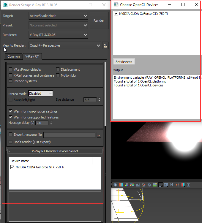

    Which Device Selector you are using, in the latest versions the Device Selector is available in the Render Settings UI but it is also available as a separate tool under the Start Menu > Chaosgroup > V-Ray RT folder:

    Does the VRAY_OPENLC_PLATFORMS_x64 environment variable exists in System or User Environment Variables?
    Does the issue appear on both OpenCL and Cuda engine?

                  For the purpose please log on remotely on each machine open OpenCL Device Selector as administrator:
                  C:\Program Files\Chaos Group\V-Ray\RT for 3ds Max 2016 for x64\bin\ocldeviceselect.exe
                  Make sure that all the GPU devices are selected, hit the Set Devices button and check the Output message windows that everything was set correctly (no fail messages).
