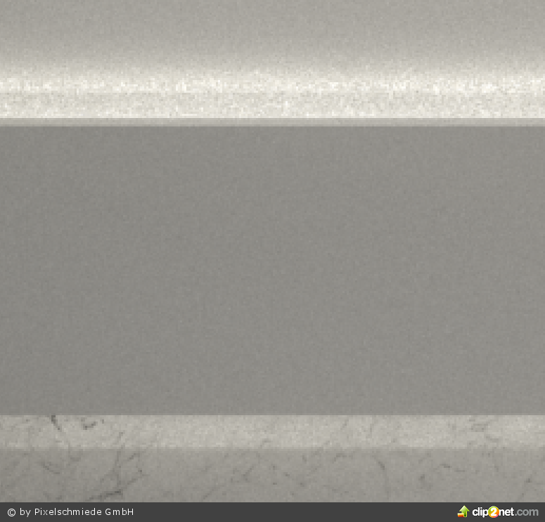

      it's not only the subpixel mapping, it's also on bright areas http://c2n.me/3wslcgQ.png I know this is worse quality, but I don't get this clean.
      but this with clamp output I didn't know. I try to disable both for testing.

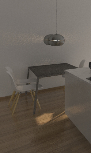

                  the problem here is
                  first image
                  subpixelmapping off
                  = very smoth image only in very bright (reflective) areas are fireflies are showing
                  render time 0:24sec
                  second image
                  subpixelmapping on
                  = very noisey image no fireflies are showing
                  render time 0:13sec
                  vray 3.30.03 (i know there is a newer version but i dont mention something in the changelog what can slove this!?)
