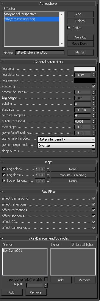

    I am using vray env fog to create basic clouds. I have 3 noise textures combined inside the fog density. The fog is using a box gizmo. For some reason it looks like (as the camera gets closer) the fog is changing phase even though nothing in the noise is key-framed.. I'm not sure why it would be doing this ?
    Any ideas ?
    I have attached my settings:

    Could fog distance be doing this or does it even affect when using a gizmo ?

    Are you animating the camera position as well?
    Can you send us an example scene to support@chaosgroup.com ?
    Is that V-Ray 3.30.05?

      Hi there. Yes, I am animating the camera. I'll send a slimmed down version of the scene now. Thanks.
      Yes, I'm using 3.30.05.
