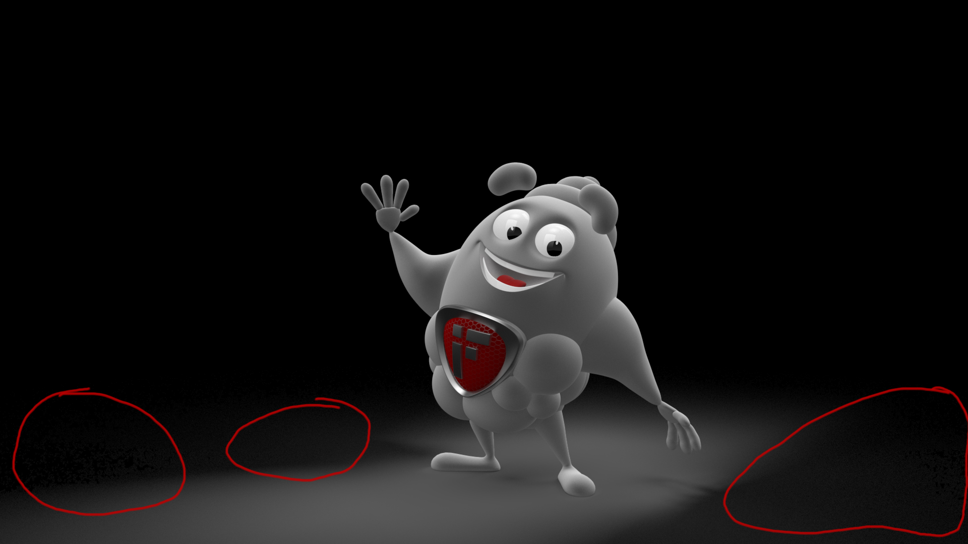

          anway, here is what i talking about.
Name:	Character animation alpha noise marked.jpg
Name:	Character animation alpha noise.jpg

            Originally posted by PIXELBOX_SRO View Post
            Hi guys,
            Although i had quite nice initial settings AA 1/100 and noise threshold 0.005, i had to to something quite ridiculous like AA 1/400 and noise threshold 0.001 to get clean shadows.
            Shadows are all to do with shading samples for your light - the aa won't help as directly.
            I tried to turn the light subdivs up but theyre all greyed out..
            Am i missing something?
            Yep - so you're using the new defaults where "use local subdivs" is turned off by default and you rely on your minimum shade rate control for all those sampling bits - go back to your 1/100 and noise 0.005 and up your minimum shading rate to clean up the shadow.

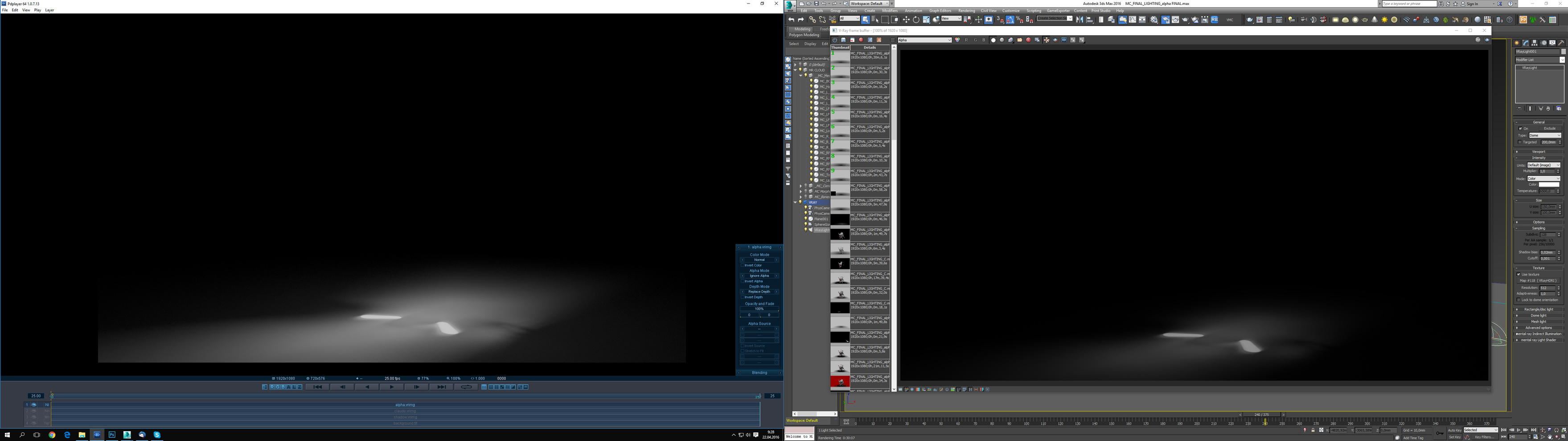

                          here are some interesting comparisons..
                          difference between comp in PD and PS
Name:	COMP DIFFERECE RGB.jpg
                          difference between alpha PD vs PS
Name:	ALPHA DIFFERECE PD_PS.jpg
                          diffrence between alpha in PD vs VFB
Name:	ALPHA DIFFERENCE PD_VFB.jpg
                          from my tests, the alpha is coming way lighter in PS and is also full of noise and artifacts.
                          PD interpretation of alpha is a lot darker, such as if it had lower gamma, nicer and withtou artifacts.

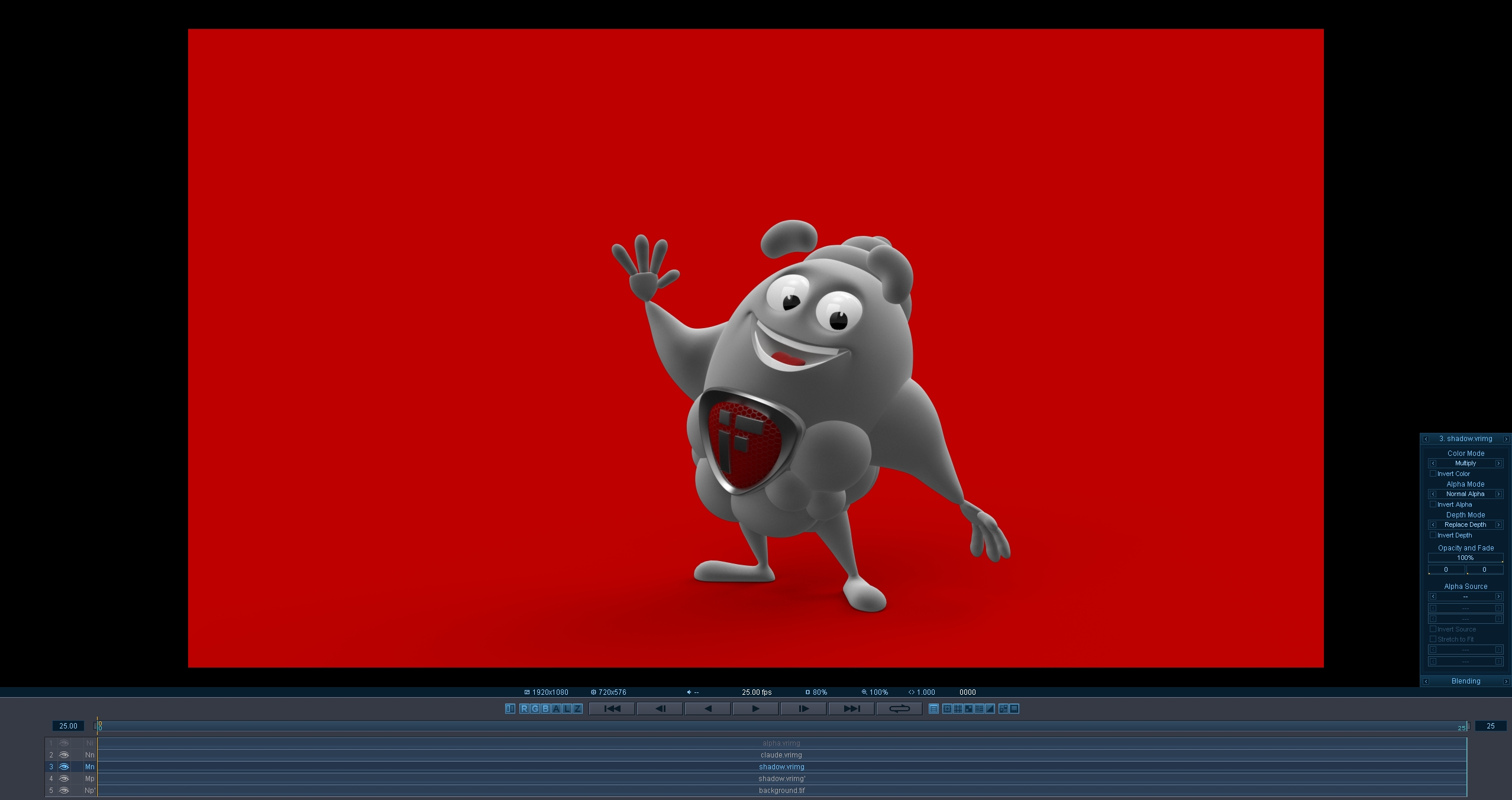

                          anyway here is the result with the clean alpha
Name:	noiseless render.jpg
                          30 minutes rendere at full HD only for the ground plane :-/
