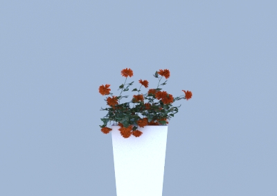

    hello,
    i have the problem that i can see the object in the alpha channel. there is nothing declared in properties or materials as i can see. default iflowers material
    the alpha channel is ok if i disable 3dsmax´s "force 2-sided"
    any explanation of this behaviour? i have this "force 2-sided" enabled since 15 years...no need for this to enable?
    thanks for help
    thomes
    max2016 sp1 vray 3-30-05

    Can you attach this scene or send it to support?
    Zdravko Keremidchiev | chaos.com
      reduced it to the minimum...
        I manage to reproduce the issue. It seems to be due to the usage of VRay2Sided + Multi/Sub-Object material when Force 2-sided option is enable and you look to the back side of the face.
