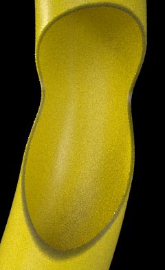

    I love the VrayClipper, but I can't get it to clip the Vray SSS materials without leaving the clipped face dark. During GI precalculations it looks fine but when it renders it's dark. Chaning parameters for the clipper makes no difference.

      Didn't make a difference, neither changing the ID of the object with the SSS material.
