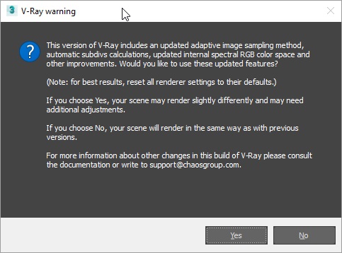

    i'm sure i'm late to the party ...
    after updating to 3.30.05 we get a nag screen about adaptive image sampling every time max is launched
    (we use central scripts and plugins location for the whole network instead of individual installs)
    is there a way to stop that?
    also is there a way to change the image sampling with UI or script after the nag screen is gone?
    thank you!

    By nag screen do you mean the notification window about the updated image sampler settings etc?
    If yes you could place the following script into Max Startup folder and V-Ray will update the scene settings quietly.
    Code:
    fn DialogsHandler = (
        -- Get the window handle of the current dialog
        local windowHandle = DialogMonitorOPS.GetWindowHandle()
        -- Make sure this is a valid handle
        if (windowHandle != 0) then (
            -- new adaptive sampler warning
            if ((UIAccessor.GetWindowText windowHandle) == "V-Ray warning") do (
                UIAccessor.PressButtonByName windowHandle "&Yes"
                return true
        return true
    DialogMonitorOPS.unRegisterNotification id:#dialogsHandler
    -- Dialogs handler
    -- Register the DialogHandler callback
    DialogMonitorOPS.RegisterNotification DialogsHandler id:#dialogsHandler
    -- Enable the monitor
    DialogMonitorOPS.Enabled = true
