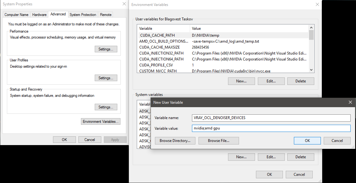

Can you set the env var "VRAY_OCL_DENOISER_DEVICES=nvidia", restart Max and try again to see if it will help ?V-Ray fan.

Originally posted by Raven View PostWhere do I set that? Is that a registry entry? Maxscript?
In the other Windows versions it should be more or less the same. For variable name you have to put "VRAY_OCL_DENOISER_DEVICES" and for variable value you have to put "nvidia". After you do this, you have to start a fresh copy of 3DS Max.

Sorry, wasn't thinking system environment variables.
Done it and it works now in max with hardware acceleration on.

Alternatively, you can set the environment variable "VRAY_OCL_DENOISER_DEVICES=nvidia;amd gpu" and restart Max/Maya. Will work just fine and will use the hardware acceleration.
