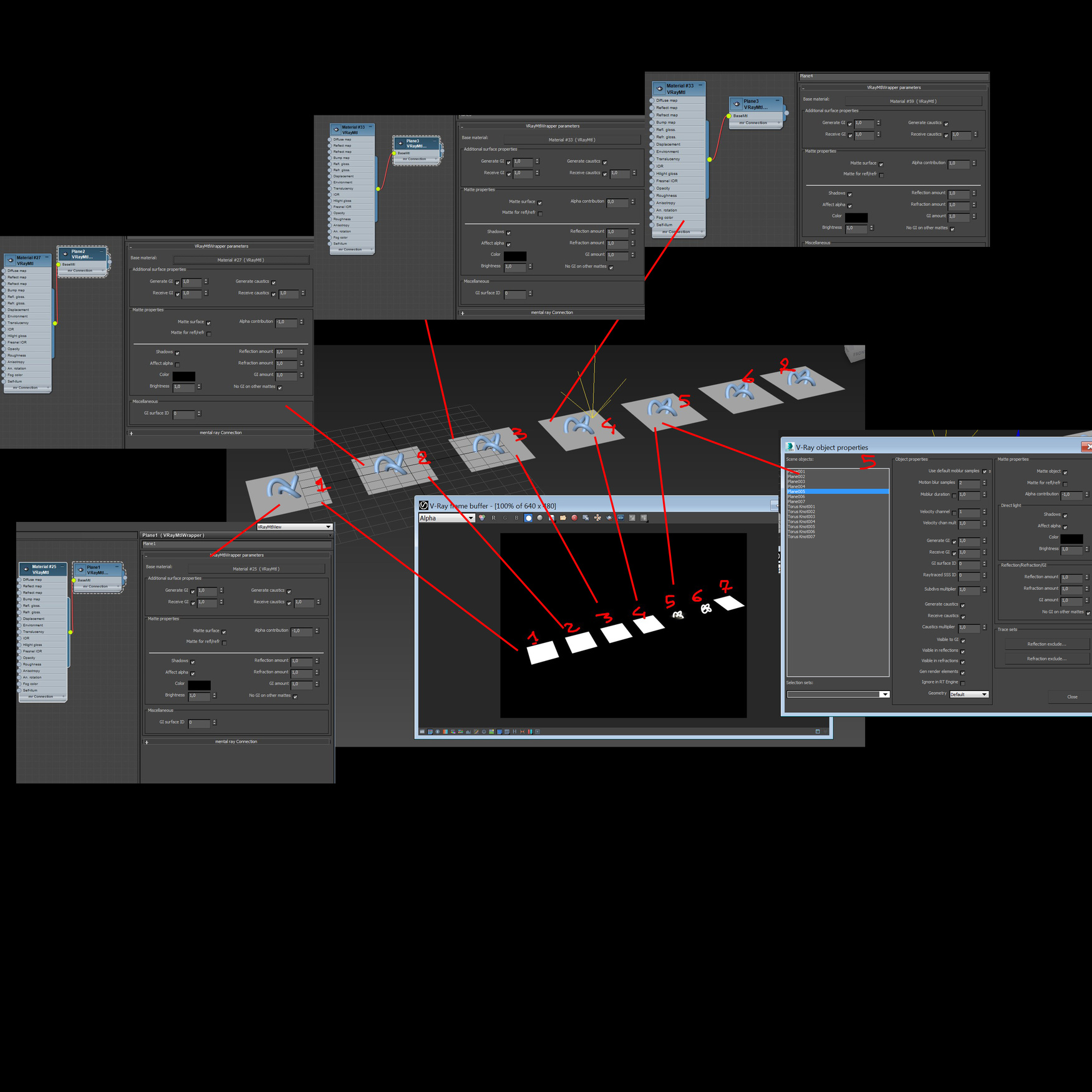

    I'm trying to get a plane as matte over a white background to compose the shadow in post prod, but I can't get it to work neither with the vraymatwrapper or with the Vray property object.
    First: The plane 1 should return the same alpha than the plane 5:
    Plane 1: matlwrapper, -1, affect alpha on, shadow tick.
    Plane 5: Vray matter p^roperty, -1, affect alpha on, shadow tick.
    I also notice that other plane with alpha set to 0 or 1 doesn't return the right value too.
    Is it a bug or it's me that doesn't understand how it works?
    Thanks

        None of the planes actually has a V-Ray Wrapper Mtl assigned, all planes are with regular V-Ray Mtl.
        When Wrapper Mtl is assigned with the appropriate values everything works as expected:

          You're right, but that's weird, as the screen shoot attached in my first post showed the assigned mat to object.
          Probably a max trouble instead of a vray one.
