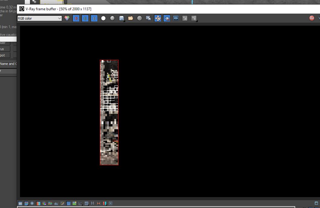

    Hi to all, I have had some problem whit the render-region.
    When the render is finished, if I do a region, the old frame is deleted.
    (I don't change any parameter between full and region-render
    I have noticed that it's happening when I use much render elements.
    Can you help me?
    sorry for my poor languageClick image for larger version

    Hi,
    Which V-Ray version is that?
    If you have added a render element just before the region rendering then the VFB has been cleared.
    Can you post simplified version of the scene to test here ?

        I have tried your solution, but unfortunately they have not solved the problem.
        I finally found the problem.
        The problem was caused by "AutoMultiMatte" script (see the image).
        thank you all for the help
