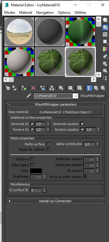

                I use the VrayMtlWrapper for the gwIvy Material
                (you can see the picture below)
                Sorry for my poor language
                  Why are you using VrayMtlWrapper ? I don't see any of its options activated.

                              I used VrayMtlWrapper because I thought it was how to convert the standar material in V-Ray material.
                              the automatic converter for the standard material in vray material do not really like
                              sorry for my poor language
