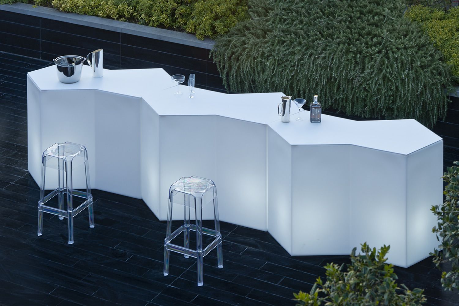

    I'm making a bar with lights in it which looks like this:
    I figured I will use VrayFastSSS2 material for this and mesh light. The problem is that the hotspot comes out dark when it should be bright. This doesn't happen with sphere, plane and disc lights. Is this expected behavior or bug?
