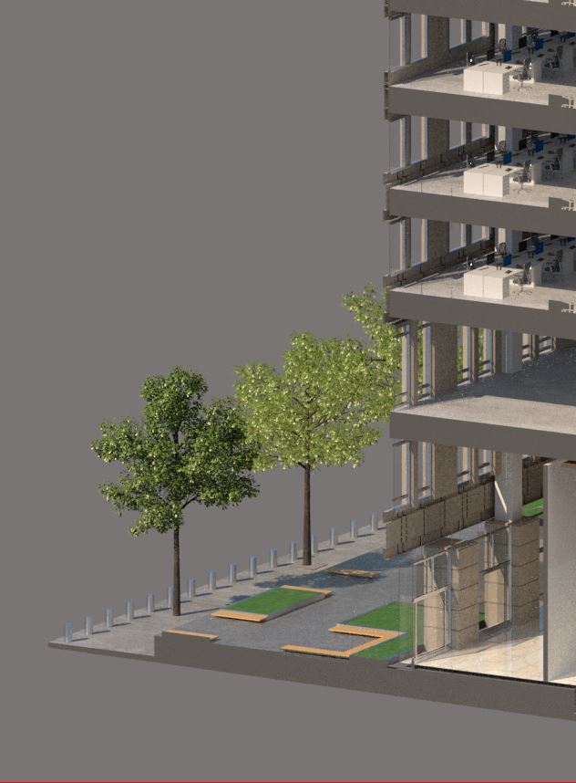

        I'm experiencing a (I think) similar issue, but not with Forest Pack. I'm just using regular vray proxy objects and I'm not seeing shadows where I'd expect them.
        As you can see in my render, the first tree is standard geometry and it casts shadows on itself and the scene normally, the other trees which are proxies don't appear to cast shadows on themselves or the scene. Same with the furniture - it's not casting shadows on the scene but it's receiving shadows from the scene.

          Hey Rob,
          Yes, we got this one
          Try assigning a completely opaque material to the VRayClipper (white on opacity slot).

            Thanks Peter.
            Completely transparent material does indeed solve the shadow problem. The only problem now is I was using the material applied to the clipper on the cut surface. I wanted to have a single material applied to all the cut faces.
            Is there any way around this?

              Hi Rob,
              Try setting the VrayClipper objects geometry Dynamic in it's Vray properties, and the material to whatever you need.
              As suggested by Peter to me. Although, this method's not always successful (didn't work with forest pack 4.4 but did with 5.02)

                Sorry I meant opaque. Make the clipper's material whatever you want as long you have a texture on the opacity slot.

                  Great, thanks guys....Got it working
