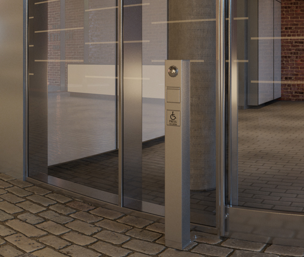

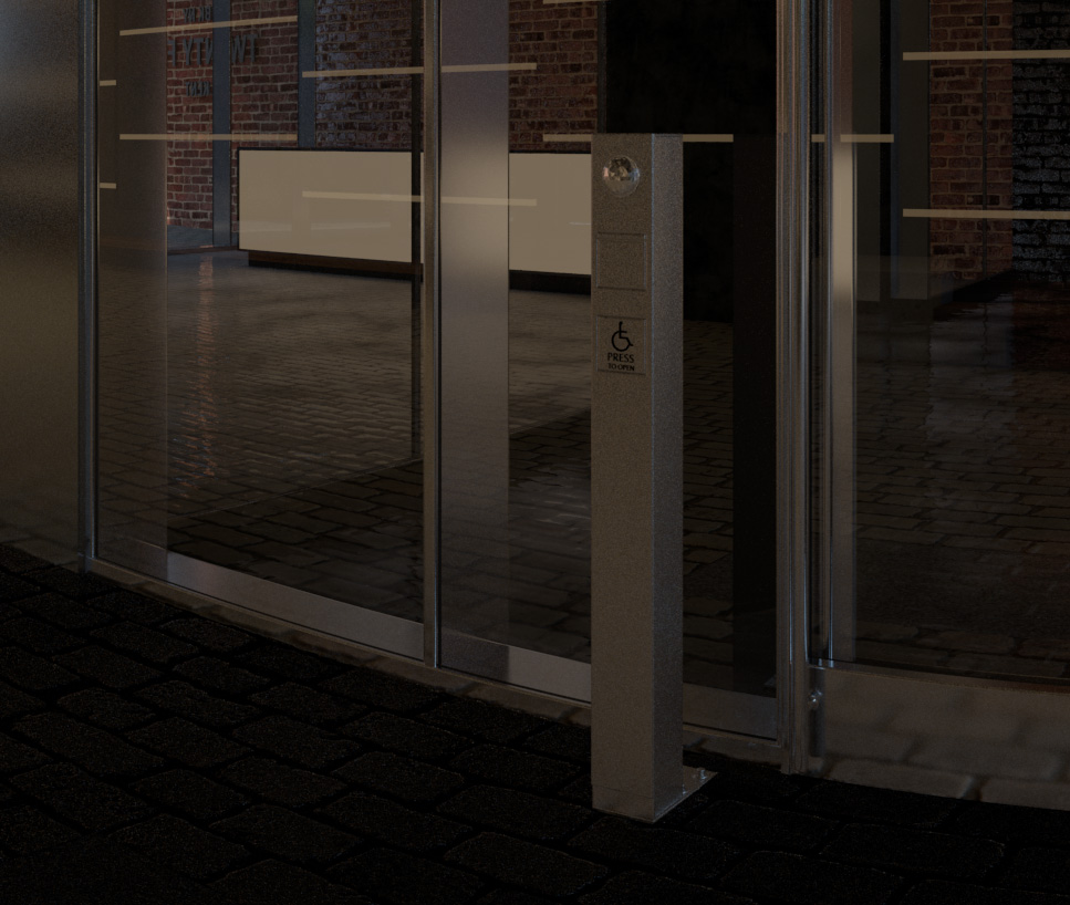

      Beauty pass looks good with the settings I rendered with, and the reflection pass is ok. There is a bit of noise in it but it is well within the realm of exceptable quality. The final setting will get upped a bit but not much. If the light pass had this much noise I would be happy but as you can see it is much worse.
        Things behind glass get a bit of a rough time of it, I'd try turning off the glass to shadow casting and see if it changes to beauty too much.
