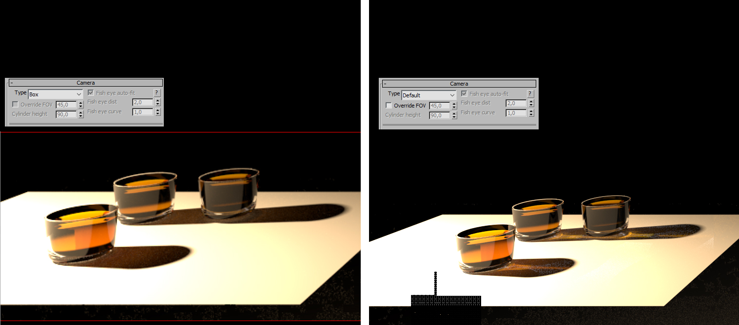

    I have a problem with the "caustics" effect. In my scene, when I create the render with the camera as "default" Type the "Caustics" applies perfectly, but i need to create this effect in "box" type instead (and it doesn't work as you can see in the attached picture).
    Any solution? Is this a bug?
    Thanks in advance.

    Can you also show me your Caustics settings?
    Vlado

        Ok, thanks. Looks like this is a bug. Will fix it.
        Vlado
