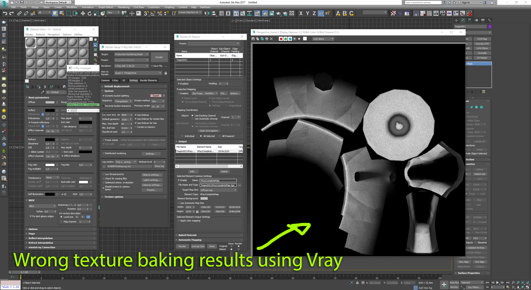

After using standard max-render-to-texture, we get this mess: (as you can see, the topology is pixel-noise)

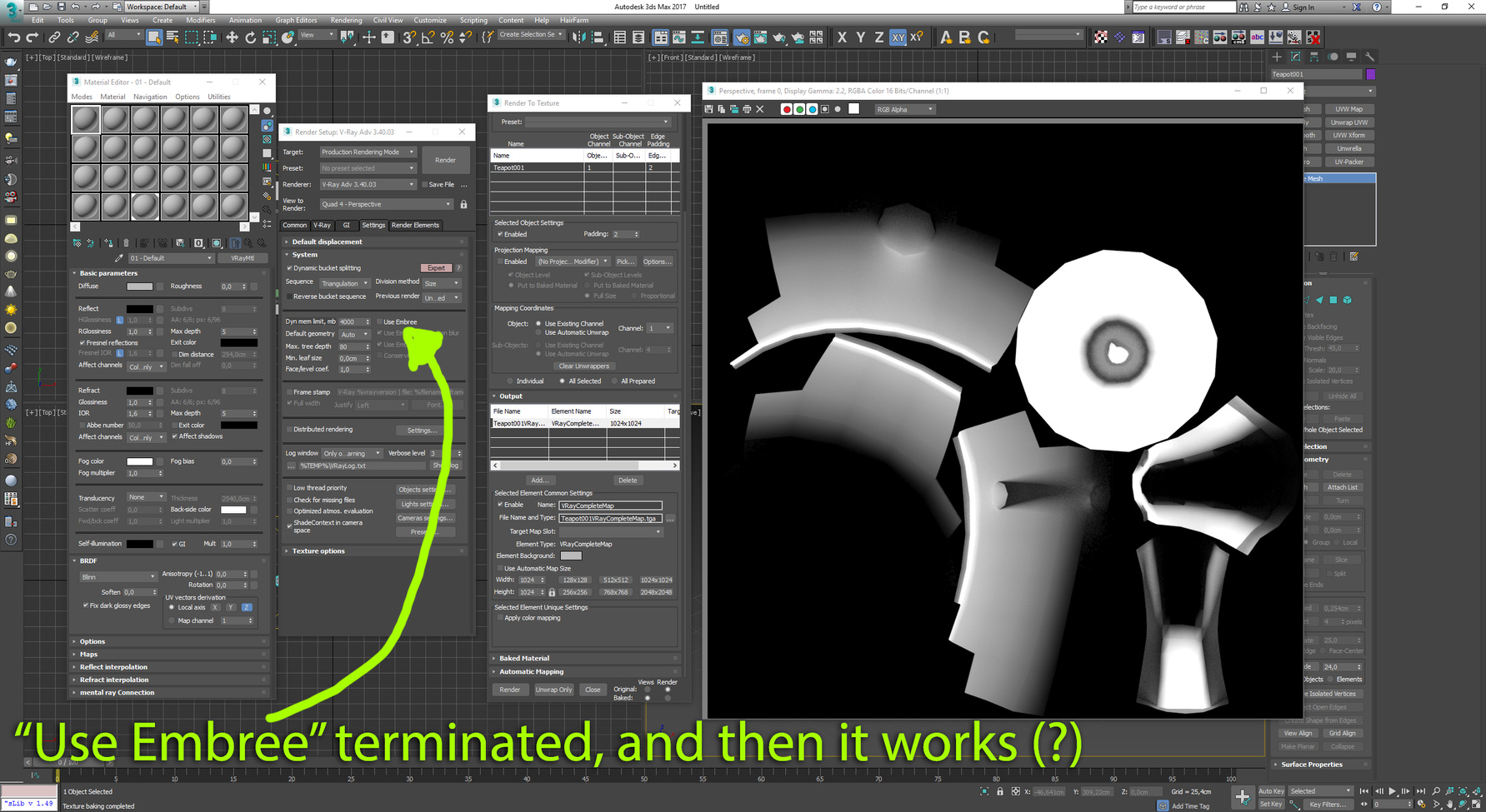

While experimenting, i have found out that if you turn off "Embree support", the render-to-texture starts looking ok.
Is it possible to fix this Embree-Error, because it is on one side ugly, and on the other side we have to struggle here with FlatIron plugin code to get it work after your last internal embree changes.
