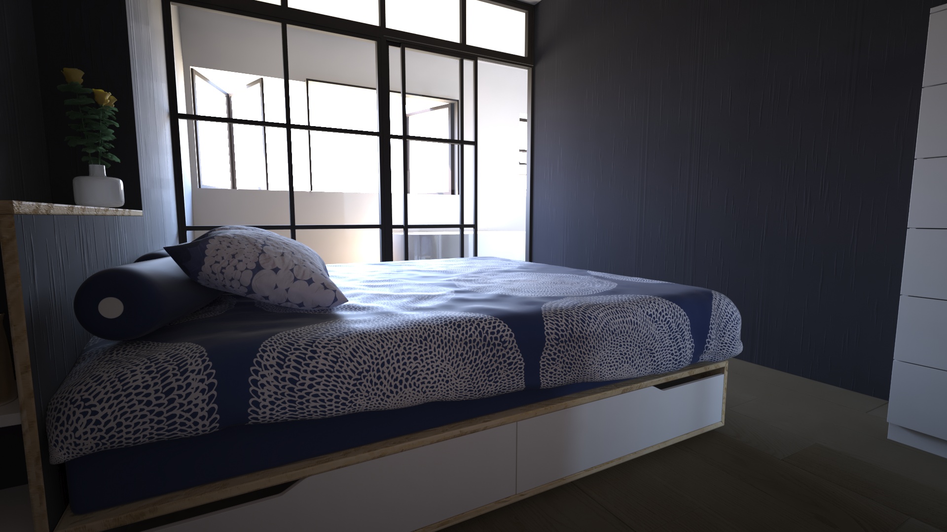

    Hi,
    in the last beta the combination of latlong and environmentFog does not work well
    it is just a test, I will need it soon for production.
    Will test in 3.4 later...

      Actually it is very weird, once I have rendered and get a bug, it is kind of persistent in any type of camera...
      This is the scene...
      https://www.dropbox.com/s/2imq8u2n9r...se002.zip?dl=0
        Also I couldn't help it but notice that camera with lens distortion don't render properly in RT...
        I can't wait for environmentFog to render in RT too, I am using it almost in all my renders and it fairly complex to render separately with refractive objects in the scene and this camera not matching exactly...

            it is the exact same scene
            RT:
            Adv:

                Yes, you have to uncheck the camera settings in the render panel to use those of the physical camera...
                In RT, the lens distortion factor is doing a zoom, but no distortion.
                  Thanks for the pointer; will fix it.
