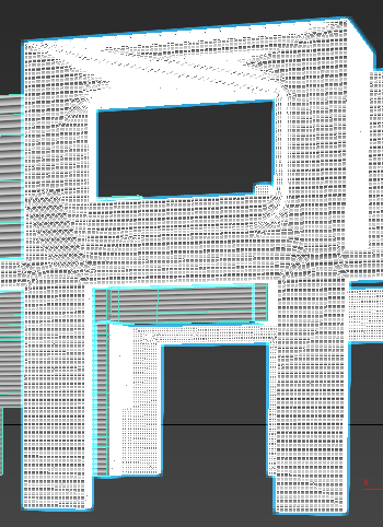

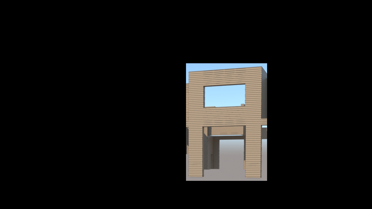

    I'm not using Railclone for this one and wanted to try displacement, but...
    I realize it's 2 different engines, but I would expect it to at least more or less be the same.
    However, RT GPU doesn't seem to be working even half right
    In case it was my geometry, I went and subdivided it a lot, but it didn't make any difference to the result. All default render settings (except switched RT to CUDA)

    Unfortunately some of the displacement settings are not fit for a GPU.
    Check footnote 1 here to see if you are using any of those. The V-Ray log also (often) warns when this happens.
