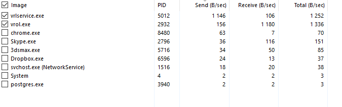

4, vrlservice.exe and vrol.exe seem to be constantly stuck in a loop sending some packets to localhost for no reason, even if 3dsmax is completely shut down. Not sure if it's correct, but it's weird. My network IO is therefore never idle. There's always vrlservice and vrol sending and receiving about 10x more data than all of the other idle processes together:
