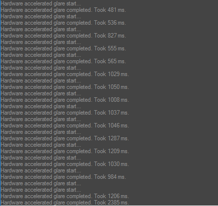

        Here is the log screenshot:

        The first bunch of 500ish times are with intensity mask off, just randomly shuffling around the weight and size parameters. Then, the 1000ish numbers are as soon as I enabled intensity mask at 1 and doing the same parameter shuffling. Third bunch of 1200ish numbers are after I increased intensity mask to 3.
        Sorry to bring up Corona again, but it can generate glare on single core of CPU faster than LensFX can on GPU, and I think it's mainly due to computing glare only from intensity masked pixels, not entire image. There, if I lower intensity threshold to 0, it slows down to crawl. But exactly same applies also for Mental Ray's Lume Glare shader, for Fusions Highlight glare node, and for ArionFX. As soon as any other generator computes glare from entire image, it slows down to crawl. So I hope that if LensFX got optimized in a similar manner, it could approach realtime framerates given how fast it generates glare without intensity mask.
          Besides any optimisations the code may need and want (6/9/1200ms is a long time? We have different standards, but then again, maybe i'm just an old and slow geezer.),
          was explained to you here:
          In the case of V-Ray is trivial to verify your intensity mask acts as a series of virtual camera apertures, and masking changes the shape of the resulting glare, it's not a cutout on top.
          So intensity masking will add calculations, and will change the shape (and fringing) of the glare much like an obstacle image would (that too is added time. and beauty.).
          And you kindly verified it: a low intensity mask makes one big diffraction aperture, a higher value will block more of the image, generating more finer points to calculate patterns through.
          It's clear the code between the apps is different (i think i mentioned this in my previous post too.).
          Why would you want us to conform, i wonder, when we're offering you a choice the others apparently do not (if one has to infer from the identical behaviour of their algos, as you put it.)?
          I would be extremely interested at seeing a comparison of the results for identical renders (a few lights would likely do fine, provided they all were of the same rendered intensity.) with the different engines, and nice, solid numbers and image analysis to spot differences.
          You seem to know them all well, so why not do one and share that?

              Lastly, yes, 1000ish millisecond times are not long, but it was measured on 1280*720 images. It's gonna grow up on something like 3508*2480 image
              It will grow by exactly the same amount as the image area (or MPx) will, and very linearly so.
              So by my maths, if 1 Mpx takes 1000ms, you can expect the same image at 9 Mpx to take nine times longer, or nine seconds.
              Likely less than it takes Photoshop, or Max!, to open from cold, for that matter. ^^
              Given if it was made realtime at 1Mpx it would come to a ninth of the required 60FPS (i'd assume. more?) at 9MPX, what's the target resolution you'd be happy with for realtime operations?
