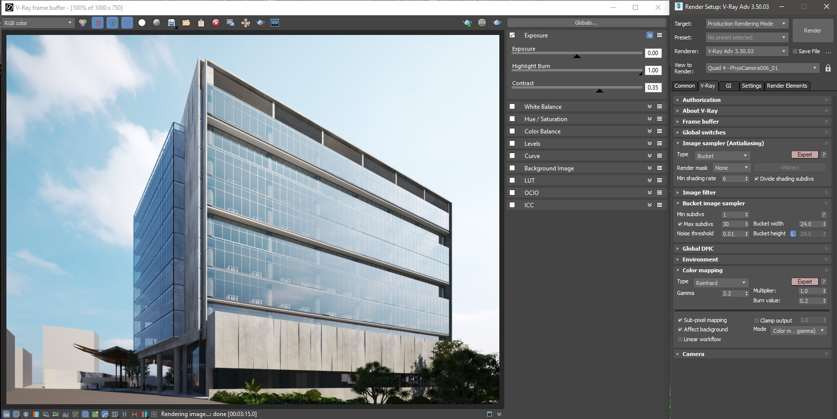

3.5 Exposure difference??
Can you clear the geometry from the scene and send it over? (just the camera and the lighting/environment - peter.matanov@chaosgroup.com)If it was that easy, it would have already been done
Peter Matanov
Chaos
That's unrelated to what colorspace you are using though
It's just that the Contrast slider in Exposure rollout was applied linearly in 3.4, and now in 3.5 it is applied in sRGB space. So if you set contrast to 0, and compare your image to one rendered in 3.4 with contrast also set to 0, they should match 1:1. So in other words, Contrast slider in 3.5 does a bit different kind of color correction than what contrast did in 3.4
