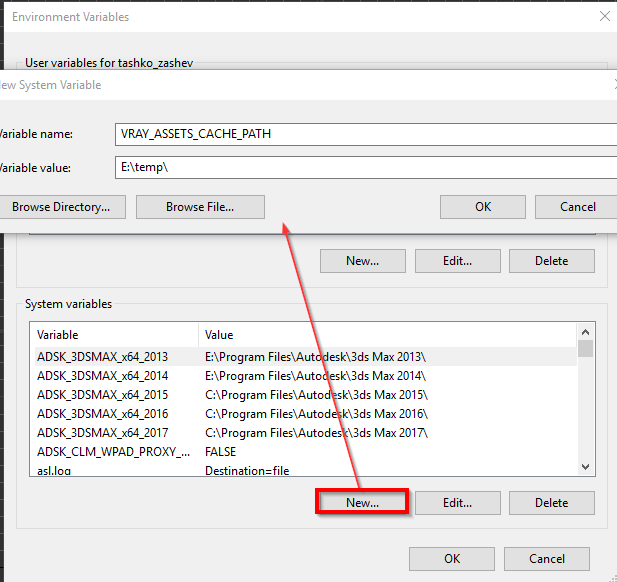

    Also, how do you get to the command line to setup an alternate directory for the vray_assets_cache folder? The help doc notes "The location of the assets cache can be modified with the environment variable VRAY_ASSETS_CACHE_PATH" but where do you access the environmental variable?

    To add VRAY_ASSETS_CACHE_PATH variable to your system please open the Control panel > System > Advanced system settings > Environment variables. Then create one new variable as shown in the screenshot below (you can change the example path ):

      The vray_assets_cache_path solution worked; thank you.
