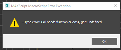

            I am having the same “anonymous codeblock” issue. I have removed the scripts from the “C:\users\%username%\AppData\Local\Autodesk\3dsMax \2017 - 64bit\ENU\usermacros” folder, and Max 2017 does start without error. However, when I add a the V-Ray Plane script to the Max Ribbon Interface as a shortcut, the message reappears upon restart.
            I receive this message a few times and the "VRay-VRayPlane.mcr" script is opened in the background.

            Does there need to be an update to the usermacros that are being auto-created? It looks like it is getting hung up on the “enabled=checkProductRenderer()” command. I have tried this with the V-Ray Plane, Sphere, Dome lights as well as the Displacement Modifier with the same outcome. Any thoughts?

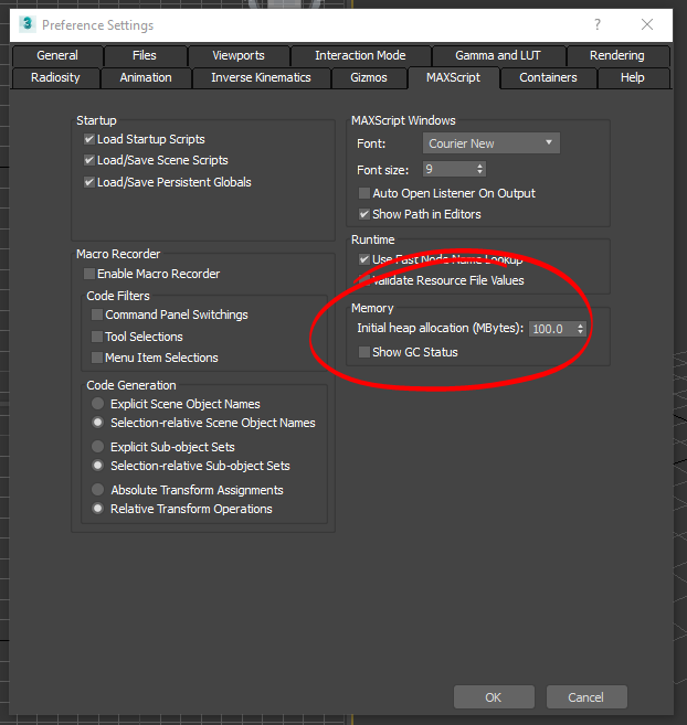

                  I increased the Maxscript Memory Heap size from 15-100MB thinking it was an “out of memory” error, but that was not the case. Memory heap is fine. Does anybody have any other suggestion to try?
                  Setting location: Customize>Maxscript> Memory heap allocation.
