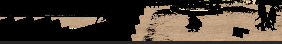

    Hi everyone,
    I have a problem with the Vray Shadow element. It produces weird artefacts in my rendering. I already tried rendering without forest, railclone, any proxy objects etc. but the artefacs change position but remain.
    Also rendering on an other pc does not change the result.
    I attached an part of my shadow map.
    Thanks a lot in advance!
    Set the light evaluation method to "probabilistic" or "full evaluation". We added a warning about this in 3.50.04. We'll figure out some solution for this sooner or later.
    Vlado
