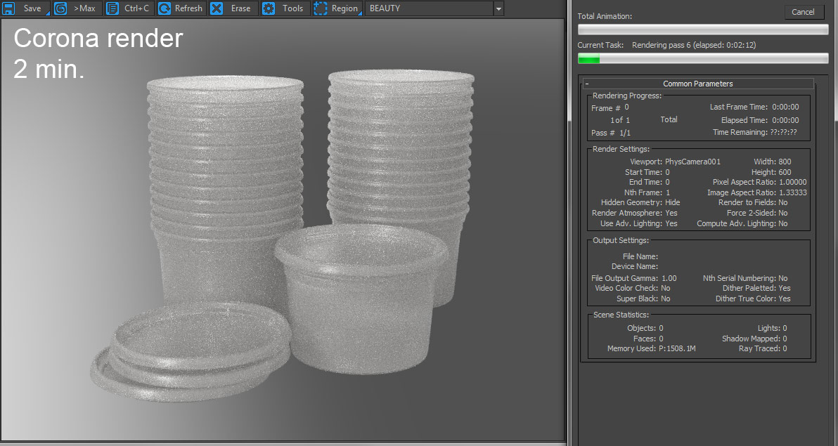

    PS: I did a test with Corona. It takes just 2 minutes to render what Vray needs whopping 8-10 minutes. I also see Corona's light cache (called HD cache) takes approximately 3-4 times less time to calculate. So I'm getting 4-5 times less speed with Vray. This certainly can't be normal, can it?!? See below:

        From your images, it looks like there's a lot more light scattering going on in the V-Ray image than in the Corona one, which generally looks darker - that explains why it also renders faster.
