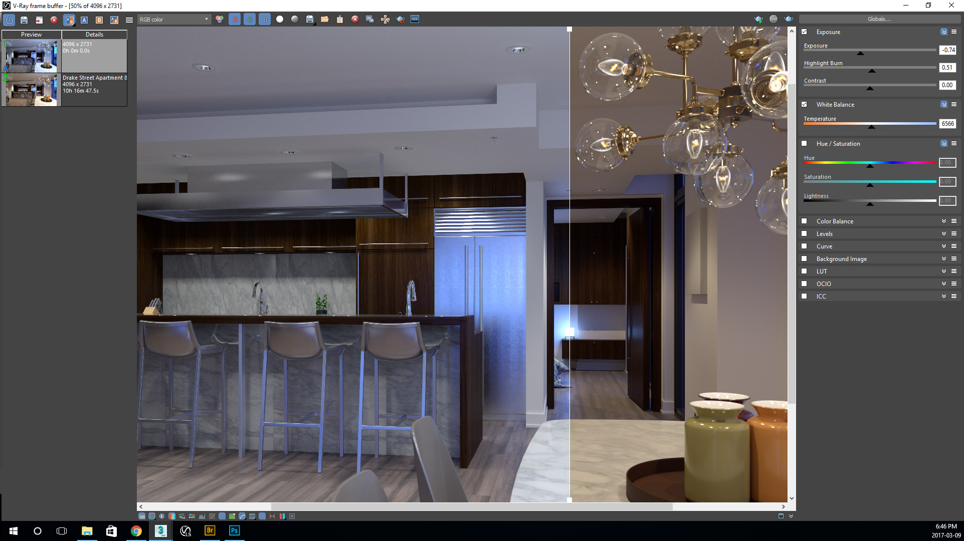

    I thought I would take my new cards for a spin. I rendered a simple indoor scene in 4k. HDRI dome, portal lights and IES pot lights.
    i7-6800k 3.4 GHz - 10h 16m 47.2s
    2 x GTX 1080 8GB - 3h 50m 00.0s (roughly)
    I used default render settings in both cases with a noise thresh of 0.005 (Vray 3.50.04, Max 2017, Windows 10).
    A few things I noticed (GPU left, CPU right):
    Stainless steel shader looks very different. Particularly in the reflections, seems noisier. GPU is cooler and appears quite a bit brighter. IES shadows are also blurrier in GPU.
    Also, I thought images like this would render much faster on 2 GTX 1080's. Am I doing something wrong?
    I know the two renderers are meant to be different. What are the reasons for these differences?

            As a start I want to point that V-Ray CPU and V-Ray GPU are two different engines and as much as we want to make them output the same results in some setups this will not be possible.
            In your scene the biggest difference between those two renders is in the lighting. The cause is the use of light portals which are pretty much very differently calculated in terms of rendering with GPU and CPU. Making them "Simple" will somehow make the results closer but they will never be the same. There is also a little bug in the textured VRayLightMtl which also contributes to the difference in the lighting.
            V-Ray GPU handles textures a little different than CPU, that's why the bump in the steel shader looks different. If you want it to look the same and still render with "Full size textures", you can resize the texture manually to something smaller (256x256).
