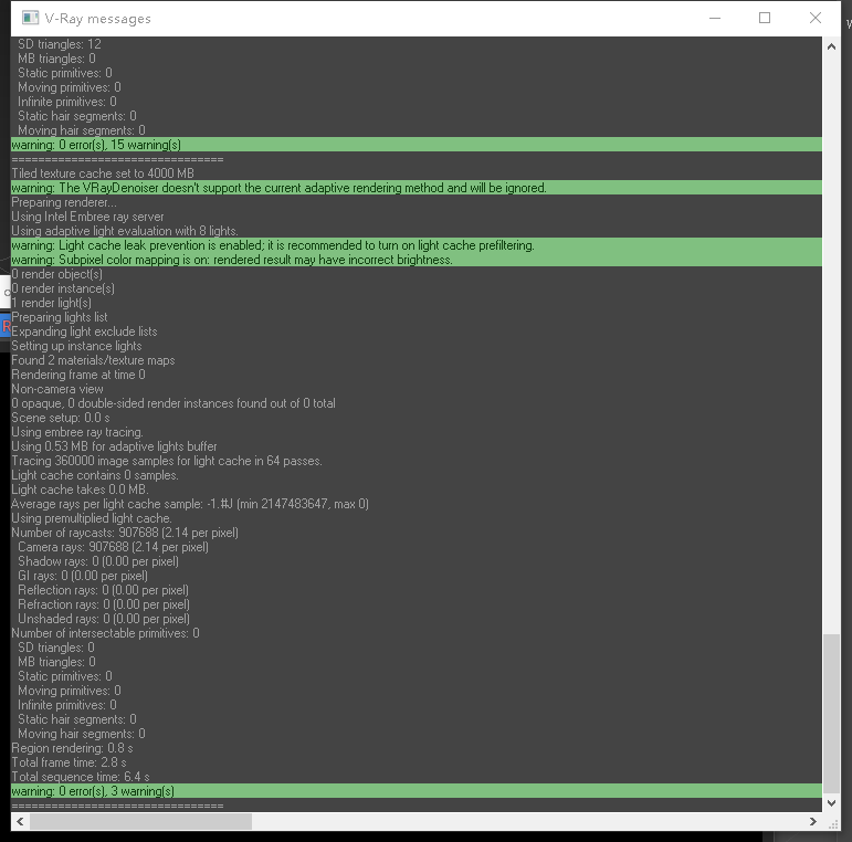

warning: The VRayDenoiser doesn't support
  • warning: The VRayDenoiser doesn't support
ID:	887244The previous version did not appear this error, how can I solve it? My English is not good, trouble you tell me the detailed way, thank you! Warning: The VR adaptive do not support the current adaptive rendering method and will be ignored.
    Hello
    You can use the following MaxScript:
    Code:
    renderers.current.twoLevel_adaptiveMethod=1

      Every time you render a new scene, you need to run the script manually. There are more than a thousand computers as a rendering node, each have to run really trouble, can you tell me a more simple way? Thank you!

        No, you don't as the default setting is 1 - unless you specifically saved a "default" preset with the old value, or you have a startup file that sets the old value. In which case, you will have to rework the preset and/or adjust your maxstart.max file. Also this setting is saved with the .max file, there is no need to do anything on the render slaves at all.

            It depends on why the option keeps reverting:
            1. Do you have a custom maxstart.max file?
            2. Do you have a custom V-Ray default present?
            Vlado
