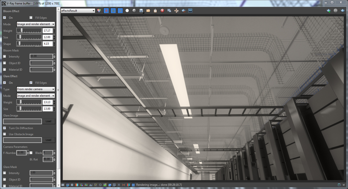

    I need some help with light effects in V-Ray 3.5. In my scene, when I activate bloom and glare, as much as I play with the sliders for their size and strength, I can't get a good and realistic effect.
    It feels like all the scene becomes blurry, effects are not isolated just around the lights as it should be. Or if I decrease their parameters, the effect is almost not noticeable any more.
    Any tips? What am I doing wrong? Attached screenshots with and without lens effects.
    Thank you.

    try enabling the intensity mask for both bloom and glare. Assing an object ID to your light or material ID to self illuminated materials
      Also make sure that if you use reinhard burn, not to use it in the rendersettings but only in the VFB. They changed the behaviour of the Lens Effects, and if you use any colorcorrection it's hard to achieve a good result. Leave the burn at 1.0 and just tweak the VFB burn.
        Thanks , adding an intensity mask seems to help a bit, still not 100% satisfied though...

                In the general setting i am using HSV Exponential instead of Reinhard.
                Keep in mind that the HSV Exponential will clamp the intensity of the light to one. This will diminish the lens effect to a level that you need to increase its settings to see its effect. With such a low settings every bright place in the scene will be affected by the lens effect. If you instead work with linear values (Reinhard, burn = 1) the lens effect can be easily set to affect only the light because its intensity will be much greater than anything around.
                  This was very clear. Thank you for explaining that.
