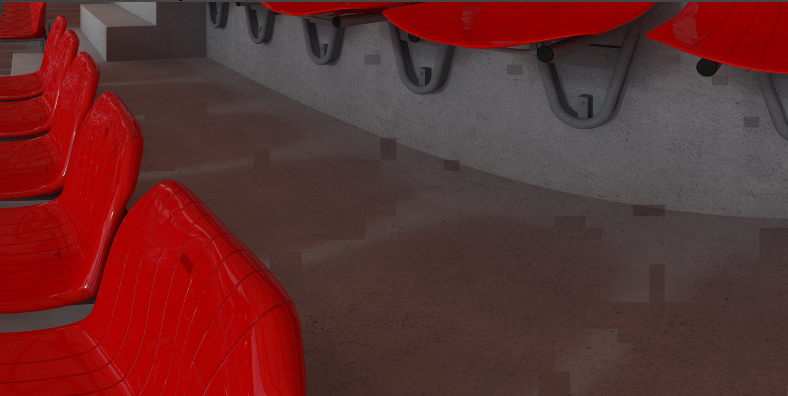

    We have a serious issue regarding our rendered images. It happens randomly and not everytime on the same server or the same image but as you can see we have some artefacts that seem "unprocessed" but the image is saved and finished.

    Is this image rendered on a single machine only or on multiple machines with V-Ray Distrubuted Rendering enabled?
      It has been rendered on only one machine. We do not use distributed rendering yet
        We managed to fix this issue by going back to an older Vray (3.2 actually). We also think this might have been caused by upgrading our whole farm (Vray 3.2 to 3.5) while we were making this scene.
          The scene was build with 3.2 but when rendered with 3.5 it gives those artifacts?
          This might be a bug, are you able to replicate it each time?
          Is there a chance to send us the scene for investigation?
            Yes I think this might have been caused by openning our scene after the upgrade and ticking "yes" (when vray asked to modify the parameters to the new version). We couldn't replicate it since it was very random. For instance, we have 18 machines and we rendered 200 frames two times (2 productions). The artefacts did not appear on the same frames or the same machines on our two productions.

              Have you got some render elements exported, would be a good idea to know in which one the artifacts are more prominent?
                Please update to V-Ray 3.50.04 and check if the problem is still there.
