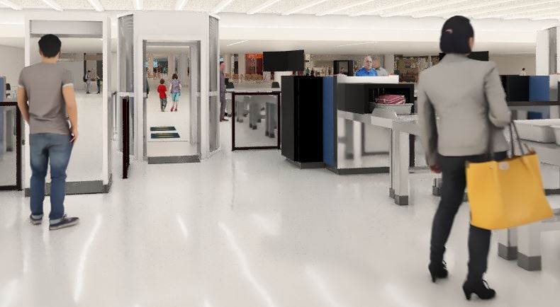

    I'm having very random issues with proxies rendering incorrectly. This is a moving camera with motion blur, but the proxy people are stationary.
    Rendering settings...
    Primary = Brute Force
    Secondary = Light Cache, precalculated, 3000 subdivs, use camera path.
    Bucket sampling 1/16 min/max
