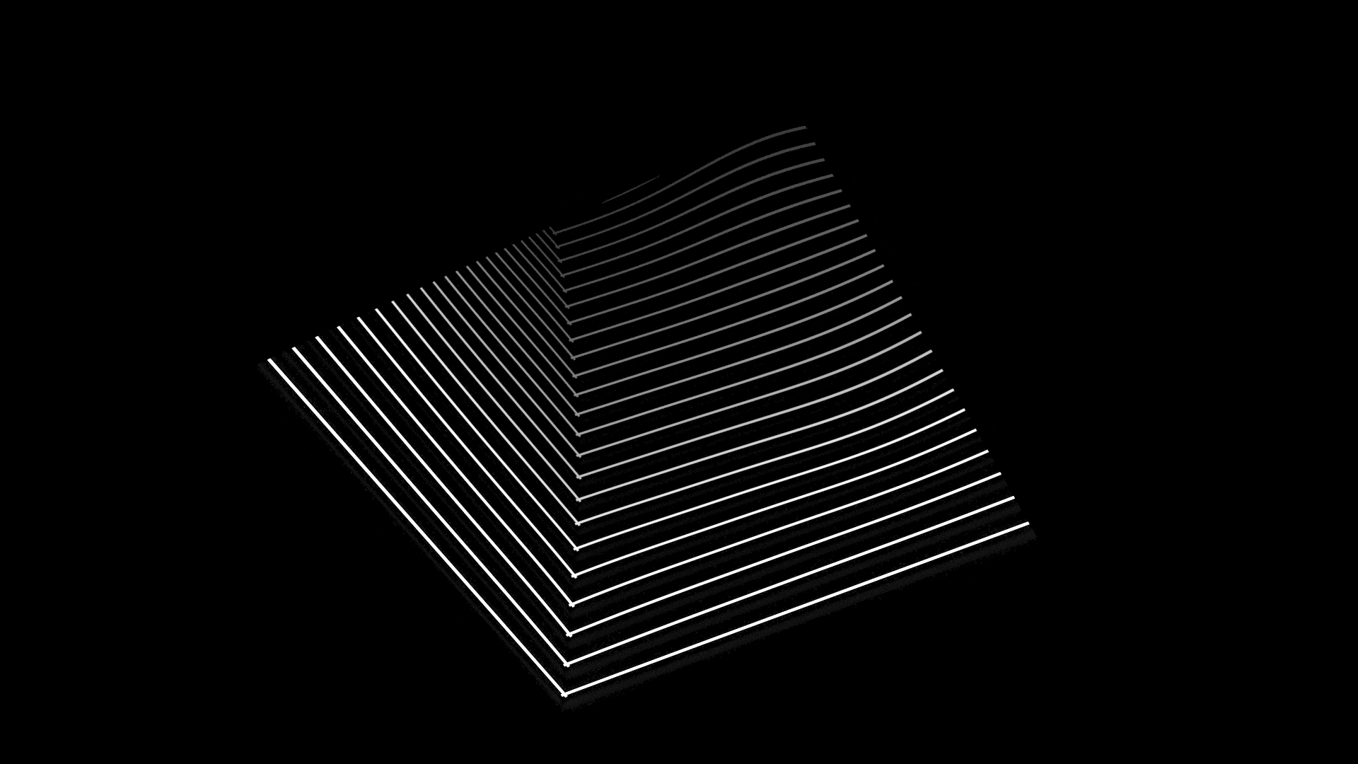

    • #17
      Ok, this can only be done like in real life, there is no need to change anything except max depth in materials and for GPU trace depth.
      Scene that includes CPU and GPU versions.

      Take careClick image for larger version

        I cheated and used a plane, if you put a plane in your scene one side you can see and the other you can not, so the invisible side points to the camera and reflects in the opposite plane (mirror).

            Sorry for the delay I was away for a few days. In my example above a few posts you can see there are 2 planes in the scene, the one in behind (representing your box in this case) has the normals facing the camera with a 100% reflective surface, the second plane (closest to the camera) has been rotated 180 degrees so that the visible side is facing away from the camera making it invisible to the camera and the visible side is facing the first plane (or box in your case) so that the 2 can reflect against each other. I can try to build another quick scene for you to look at but the one I made above actually crashed to the desktop before I could save it but its pretty simple and fast to setup.
