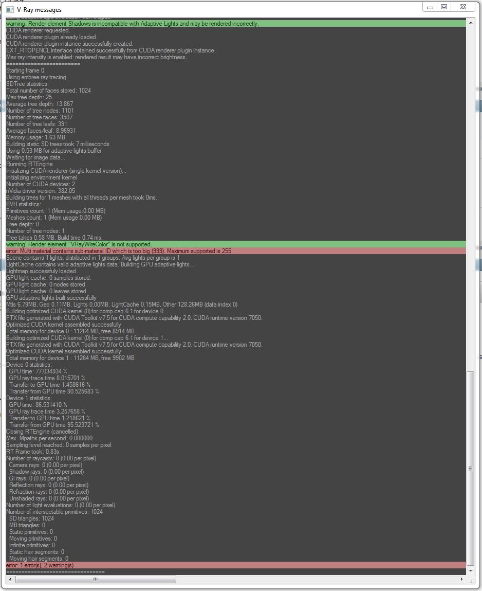

Mat ID limit 255 when using V-Ray RT ?? (no error when using ADV).
  • Mat ID limit 255 when using V-Ray RT ?? (no error when using ADV).
    I'm hitting problems with some Laubwerk tree models and as I've used these models before, I'm guessing it might be more to do with RT than ADV.
    It seems to me that a lot of Laubwerk Tree materials have a Material ID of 1000 within their Multi/Sub-Object.
    V-Ray RT is failing with an error message saying something along the lines of "there is a mat id in scene with a value higher than 999. (Maximum permissible 255)."
    As I say, this doesn't happen in V-Ray ADV.

      Yes I do Vlado - but it's a really basic scene - I'm just playing with RT as I've recently upgraded my GPU cards as I want to use RT as much as possible as the speed differences are well worth it.
      (you might well need Laubwerk - but I can collapse and send as Editable Poly).
      Instead I've created a very simple scene with just a teapot and a plane - made the handle and spout have a Mat-ID of 1000 and the rest of the teapot a Mat-ID of 1.
      Try rendering in RT and you will get an error message - render the same scene in ADV, no error message. Change Mat-ID to be less than 255, no error message in RT. I have a lot of Laubwerk Trees

        Yes, I also started noticing this with Laubwerk recently. It didn't happen before. So either Laubwerk changed their materials recently to use ID 1000, or something changed in Vray-RT and it does not support IDs above 255 anymore ?

            I just bumped into the same problem. Only with Vray RT CUDA not CPU. The Multi-/Submaterial of the plant has only 19 ids, but the last one ist number 1000 - that's the culprit. I'm going to try updating the laubwerk plugin, maybe it'll help.
            Have you solved the problem or found a workaround?
            Update: even with version 1.0.24 the problem is still there
