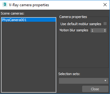

    Set the motion blur samples of the camera to 1 in V-Ray object properties (right click in the viewport).

      That's great, thanks.
        Hmm this works but when I untick use default moblur samples, the objects that are actually moving are no longer in their correct position when rendering. Its like they have fallen off the screen.
