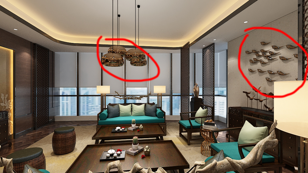

    I use genuine vray3.6 encounter a problem, the object's high light has a burning error, with the highlight of the object where the brightest place appears surrounded by black lines. Previously used vray3.4 did not happen such a situation, in the case of using the same scene and the same rendering parameters. Include an error screenshot, and render the parameter area.
    Hi,
    It looks like you are using a very sharp filter for this render. Can you try to change the Image filter type from here

      Thank you very much for your help! The problem is solved!
