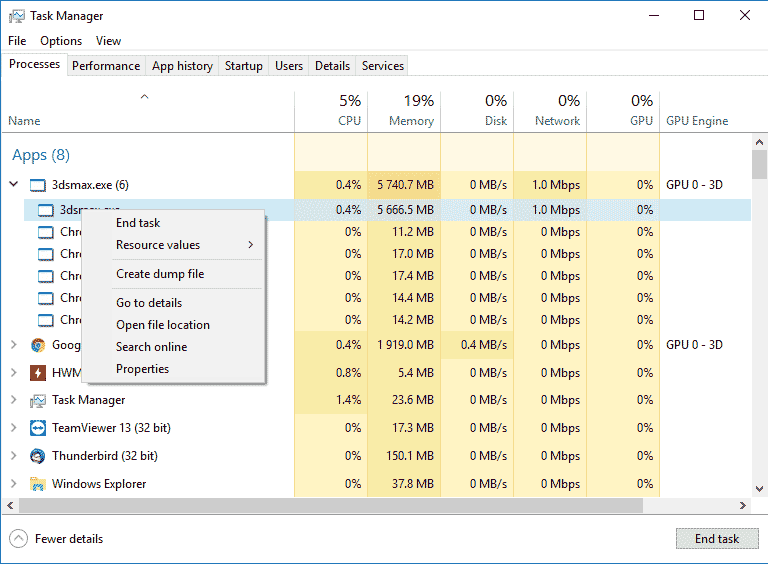

      I don't see the Switch To thingy. Please see the screenshot below. I see it on other apps but when I right click on 3ds Max it's not there. I'm using 3ds Max 2018.4 with Vray Next Beta 1 on Windows 10 Pro x64.

        Don't minimize max while rendering? Just maximise things on top of it and minimize those. In any case the switch to option is on the top of that tree "3dsmax.exe(6)" if you right click there.... I just tested it here but it is greyed out for some reason. This used to work :-\

          Yes, it is greyed-out sometimes, not sure why. In such cases you can do it from the Users tab (see image below):

            Thanks, Miroslav! I am a bit new to Windows 10 and didn't realize I could do a Switch To from Users tab.
