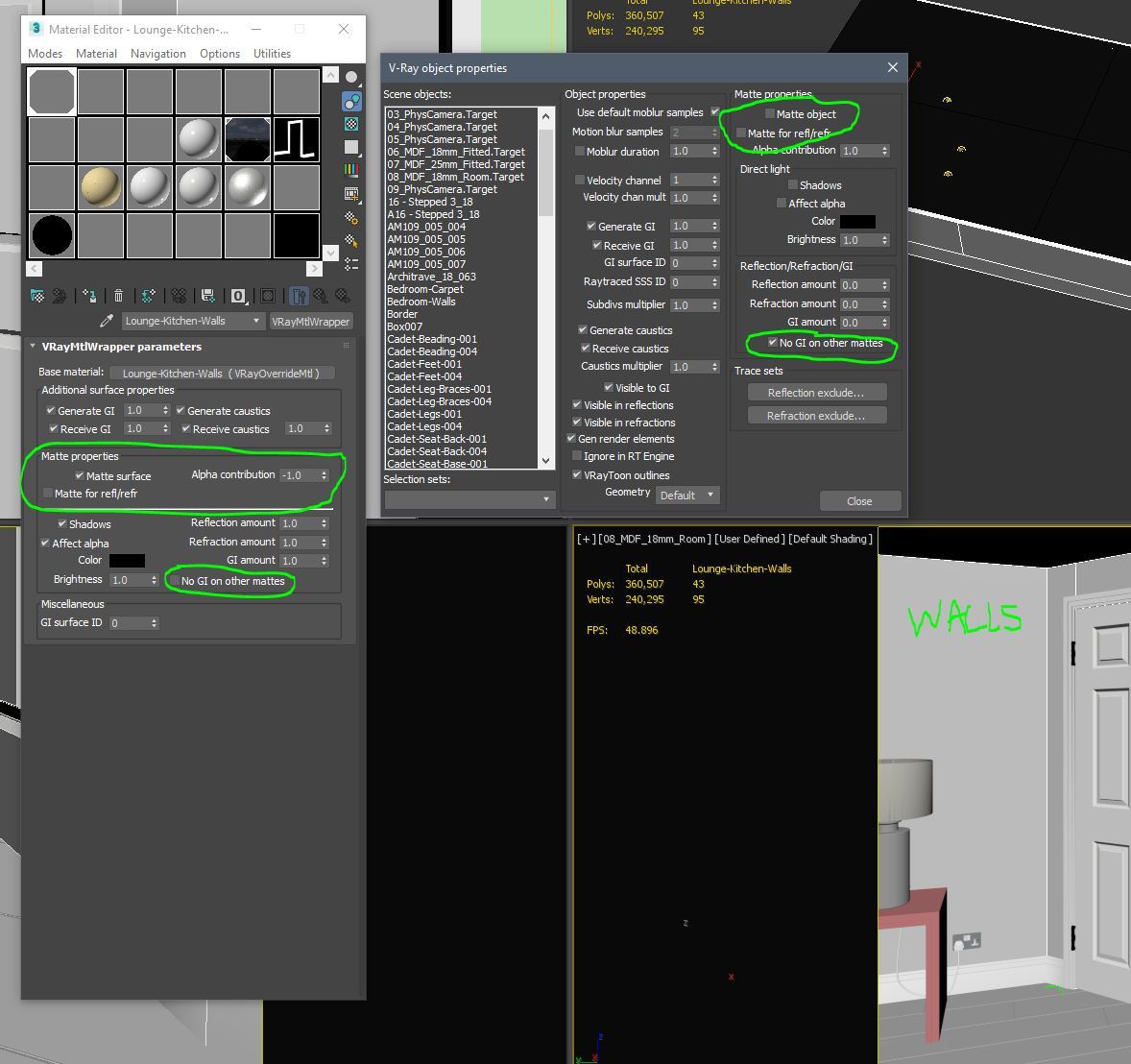

                          The wall (and some other geometry) had VRayProperties set to Matte with "No GI to other mattes" enabled which overrides the wrapper Mtl assigned to them.

                            Here are the settings that were recommended by Chaos;
