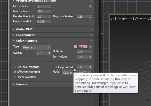

      What values have those pixels in the VFB? Have you tried using Clamp output with more suitable values?

          The Clamp output option is located under the Color mapping section of the render settings. The default value will clamp the brightest pixels to "1", but you could change that.
