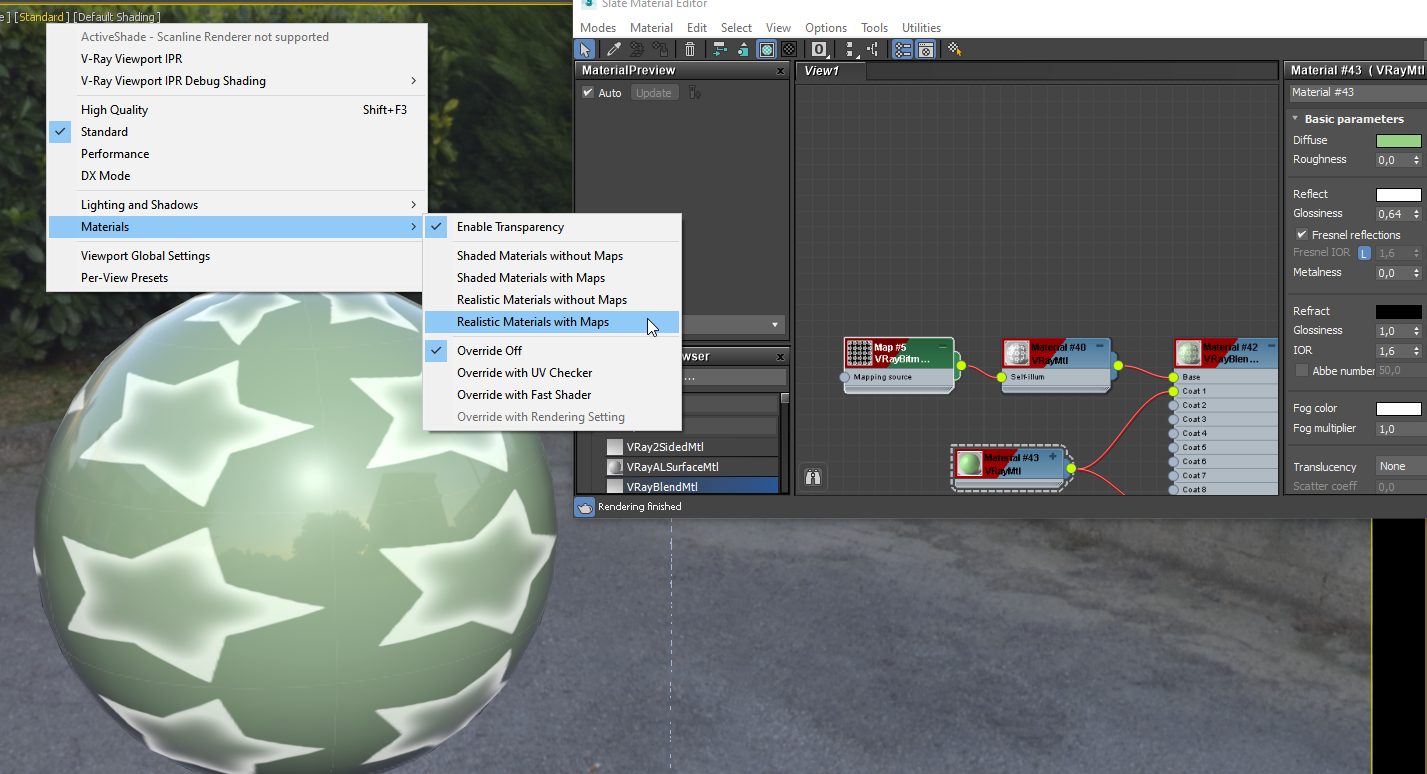

      Most things will work in the "Realistic Materials with maps" mode in Update 1. Here is an example of a map in self illum slot in VRayMtl that is in VRayBlendMtl (+ 1 coat):

      If it was that easy, it would have already been done
