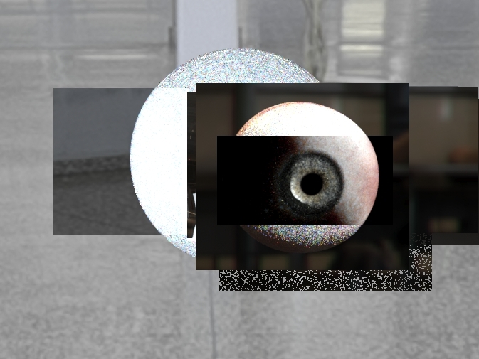

          here's my test. So my feedback is, WAY better then before, that's the good news, BUT haha it needs to denoise completely to be usefull for eyes and that I don't see it happening, most of the renders, even if I let them render, they just won't denoise.. and noise in the iris break the realism .
          so as you can see, some scene just won't denoise.. and I have almost nothing in the scene, an eey and 1 or 2 lights.. so imagine on a whole character it would take foerver to denoise

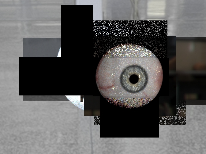

            some more with some that won't denoise anytime soon.. and there is nothing else in the scene and it takes forever so imagine with a whole character..
              here's some that were VERY noisy ... and impossible to denoise

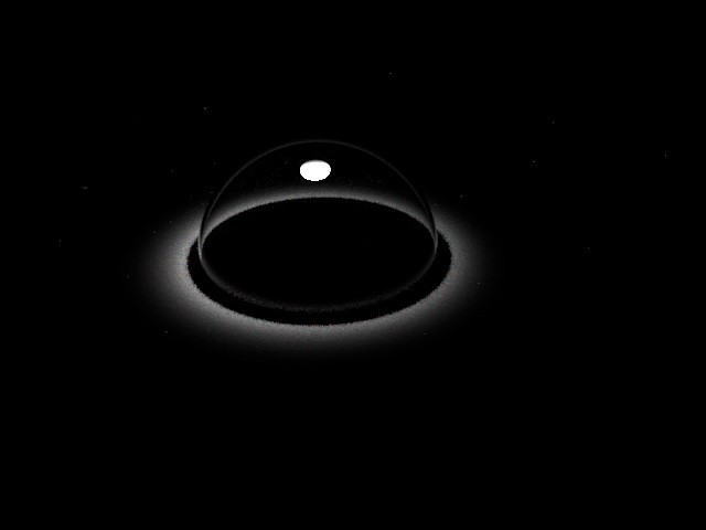

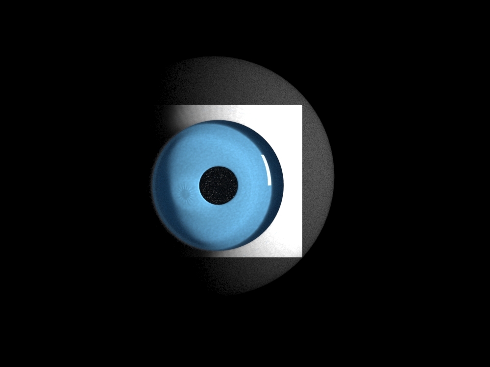

                and here's some test in Vray, doing an old trick for fast and sharp caustics.. but it's not super accurate though.. since the std light have to not cast shadow and it only work's for crips casutics so with soft light you would still get sharp caustics wich don't make sens..

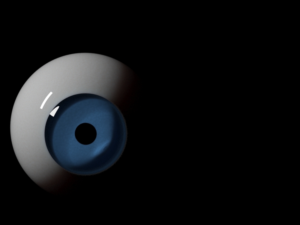

                I found that the vray soft caustics ( like the one you get with a refracted object and without activating the caustics in the render tab ) less good then before, in vray 3,6 at least I was getting some soft caustics for the eye it was helping, now there is not much.. I opened old scene and it was not looking the same..way more flat now.. I don't know what has changed in that regard, but it was better before.

                        Andy51, it's with std light ( and vray light, but the vray light need to have the generate caustic set to 0 since the caustics will come from the std max light) and in the max light, you have to make the cone just big enought to cover the are you want caustics so that maximum photons are in the zone, plus you have to put that light in inverse square and boost the strengh a lot, like 500 or more. But it's a great tips for REALLY fast crips caustics in a pool or for cars etc.
